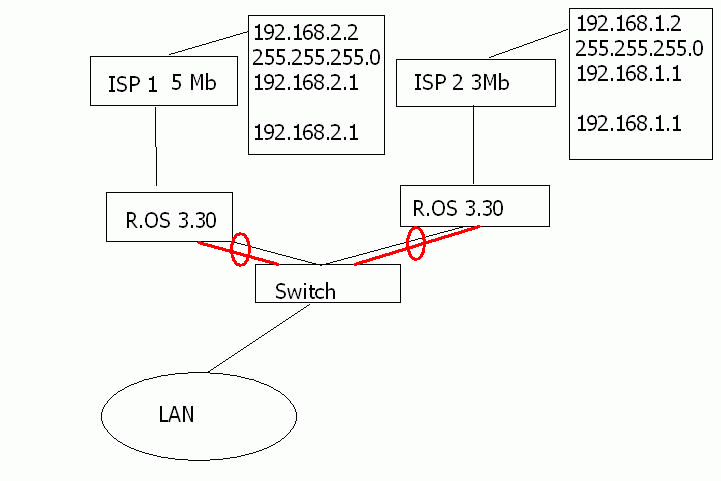

I want to make a bond between two MT box to get an agregated line.
like this?
yes!
or if i can do it in another way,just tell me. i don’t have problem to setup another mt box or to talk with my isp owner.
or if it is possible, like this :
the only thing that I want is to get an agreagated line.( out put about 6 mbit)
6 Mbit? I thought, links between ROS and the switch are 100 Mbps… so, with bonding you can increase inter-router communication upto 200 Mbits, but… why do you need that?.. don’t you mix up the things? what’s your goal?

so, you have three lines, or what?.. why not just make PCC-balancer for three lines?

but same i can’t see why need bond since use pcc
what we want to know it here for who you want to has all connection 6 mbit i think to your LAN
if that right
your LAN from which R.Os take the connection there not logical to has connection form tow r.os
what u need i think the best solution is to specify your r.OS and use pcc in it and the second will be gateway secondary
2nd solution insert r.Os instead your switch and use 1st r.Os as 1st gateway and 2nd r.Os as 2nd gateway

Yes, I have three lines but i want to make a PCC with another 6mbit line, so the only think that I want is to get full speed from these two lines, nothing more.

Or if you want, can you make a drawing of what are you saying ?

look at MUM PL presentation from Janis and Valens. the main idea is ‘1 + 1 is not equal to 2 in case of load-balancing’. so, you need PCC for three lines
Can I make working 1+1 = 1.5 (or 2) ?
In another way I mean, not by load balance.
no way. only balancing
