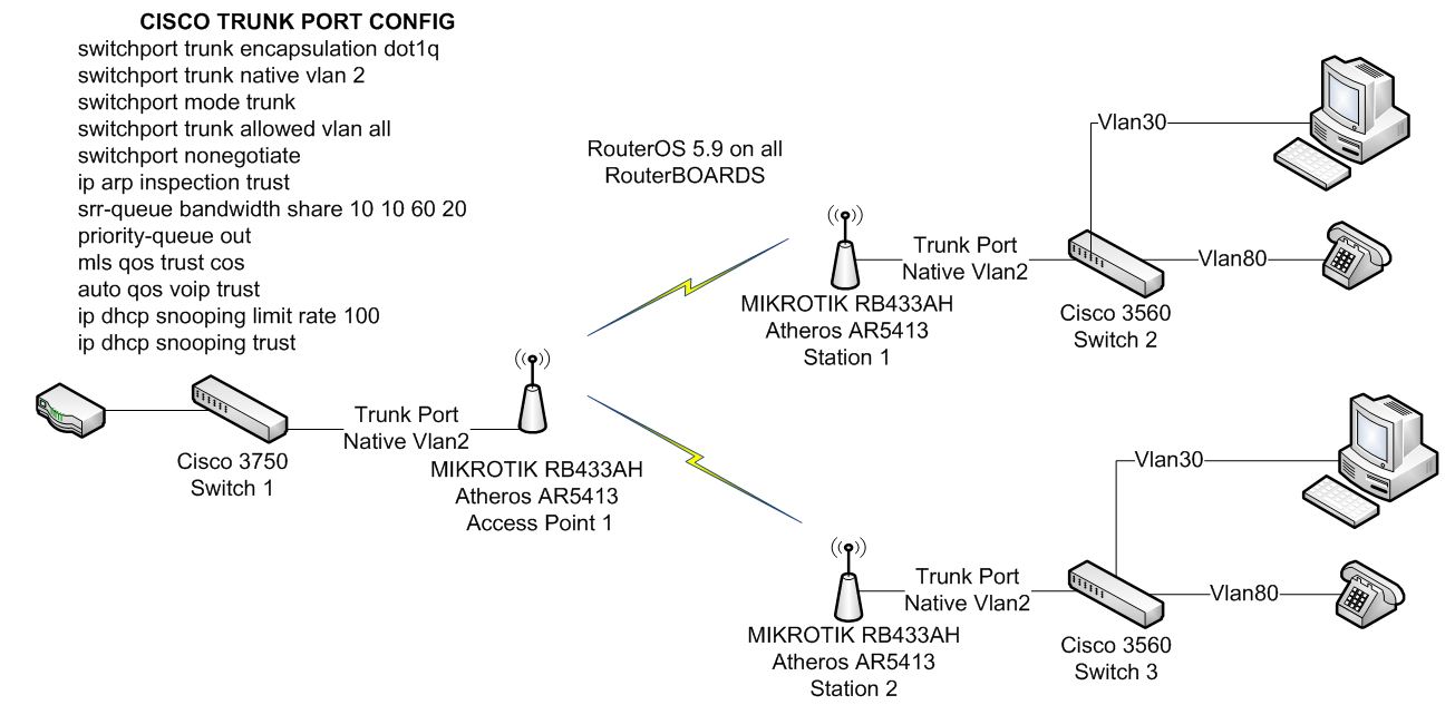

I’m having some difficulty configuring the Mikrotik RB433AH router boards to work in the following config:
Management VLAN is 60. Any ideas?

If you add ethernet ports connected to your cisco equipment to “bridge_tagged_side” under bridge ports you should have a working solution.
ref. http://forum.mikrotik.com/t/mikrotik-p-to-p-configuration/52487/1
I am new to MIKROTIK. Can you please be more specific about “bridge_tagged_side”. If you have time can you send me whole config?
Igor
bridge_tagged_side is just a name of an ordinary bridge containing tagged ethernet for vlan - similar to cisco trunk.
The hole config is there, if you use winbox and walk slowly through you should have a full working solution.

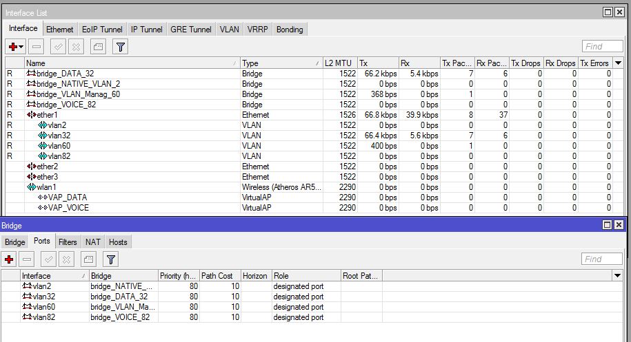

This is what i have done:
Wireless is still not connecting. I have used AP bridge on AP and station on client side.

Use station wds on client side.
could you also post the content of your wireless settings.
