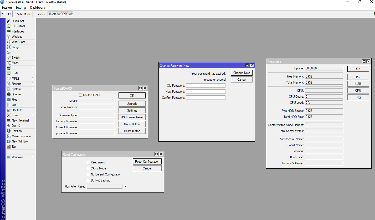

Please I need help to solve this is a new router without use that restarted because the key that is described on the label does not work.
I did a restore with netinstall to recover the hap AX2 router I followed every step indicated in the manual and the end I was told that it was ready and the router rebooted, but when trying to enter by SSH or Http does not connect using winbox and does not show any packet loaded so the winbox restarts every 5 seconds and does not allow to modify anything at all.

It’s just the winbox not displaying the information. I’ve had such cases, I don’t remember the exact cause. But the point is that the winbox does not receive information from the device, so all fields are empty.

But if it is a winbox problem you should deliver the ip dhcp, how did you manage to solve this problem in all honesty, I’ve been trying to solve it for 4 days but I can’t get anything.
Try changing the network connections. Mikrotik after netinstall has an IP address 0.0.0.0 connection problem was related to this. Something in the computer is blocking access.
Try to set the address 0.0.0.2 on your computer.
I use mikrotik ip the 10.0, 172 use 4 pc with different OS win10 win7 Ubuntu and I can not solve, it causes great frustration.
