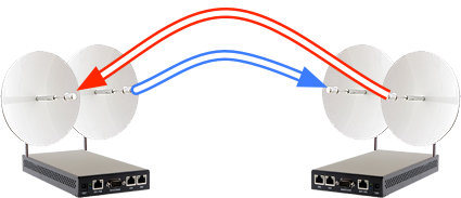

Ubiquiti AirFiber working principle is a pair of dishes each side, one for TX and one for RX (two radio links)
Is something-like achievable with Mikrotik devices ?
Or also bonding two 802.11ac links together in very different frequencies, using two devices per side ?
Yes, you can build it with MikroTik devices that have multiple wifi cards, for example Netmetal with two dishes each side:
https://mikrotik.com/product/netmetal_ac2
then use Nstreme Dual function:
https://wiki.mikrotik.com/wiki/Nstreme_dual_Step-by-Step
