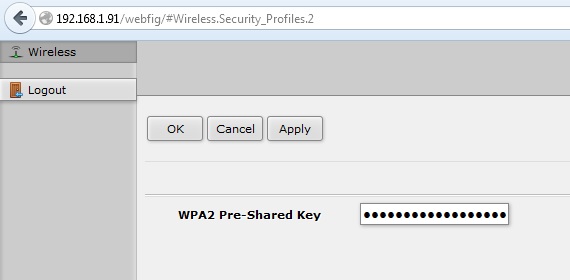

Well, normally hotspot should be used. But it does nothing with wifi. Maybe you can try webfig templates to display only particular options for his username, if possible.

Sorry, I called it “template”, actually this webfig function is called “skin”.
Here is the manual: http://wiki.mikrotik.com/wiki/Manual:Webfig#Skins
Create new skin containing only the function you want to allow to the user (wifi security profiles only). Create a new user group with restricted rights as much as possible and asigh this new skin to it. And finally create a user within this group.
And it is done!
This is the result when user logs in:
Is this what you want?
Thank you very much for your support. I really appreciate. Yes! I am looking something like this. But please let me know with which RouterOS version winfig works? I have routerOs4.0 version on MT router and when enter the router’s address in bowers it opens normal webbox. Thanks.
There is karma button for expressing appreciation. my picture is from v6.12 webfig. You should install the latest version too.
