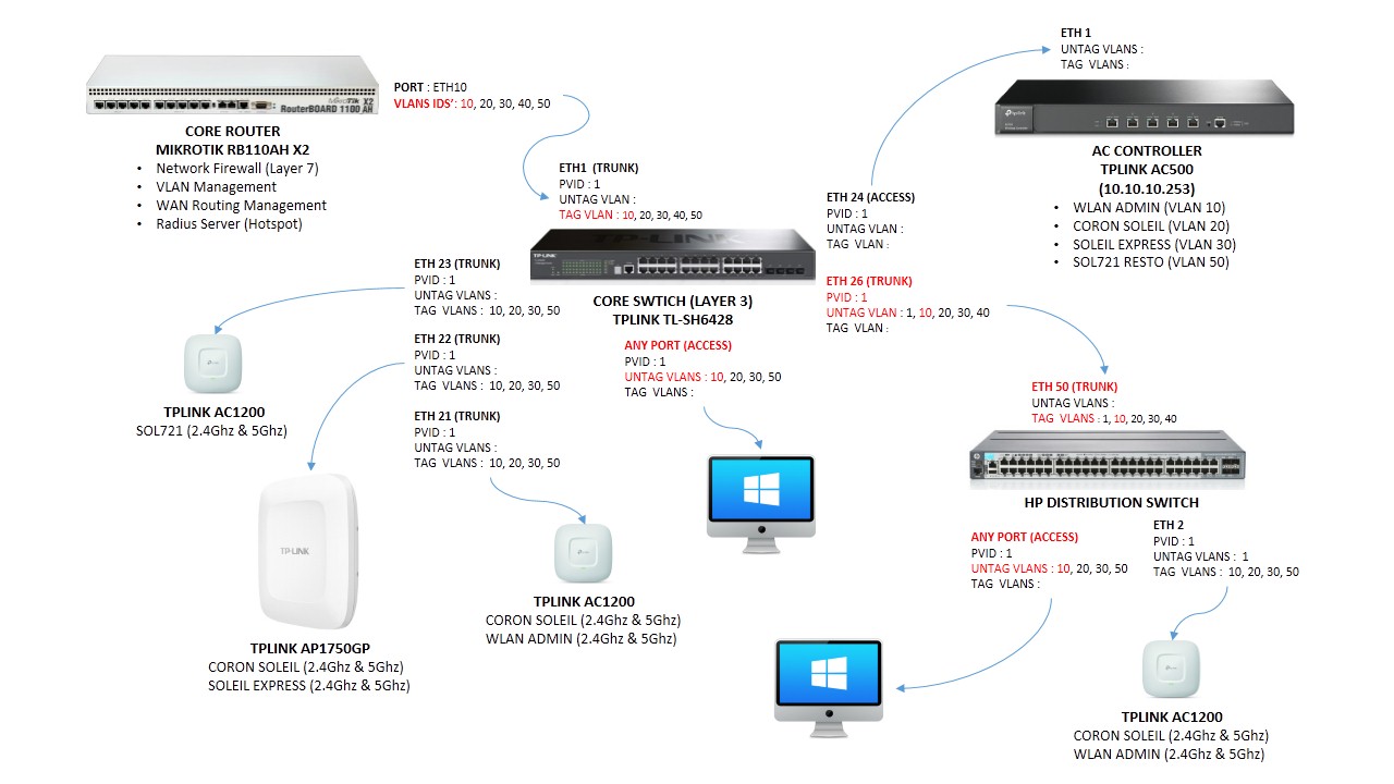

Bro you may try setup in attached file. Pay attention to red fonts. And also do you really have to use vlanID 1?? Some say vlanID #1 is reserved ID for system. anyway you can try my setup attached. from RB to core switch to distribution switch.
you can test this to your RB to switch same setup. but you have to sure that you setup your dhcp in your RB first.
GOod luck!
