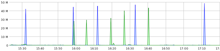

Now to the problem. With this I get these crazy spikes on the charts:
I have tried changing polling interval. No help.
I have tried using ifXtable and 64bit counters. No help.
What am I doing wrong?
The same graphs in 3.6 looks perfectly fine.
