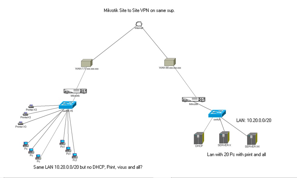

I need to setup a Site To Site VPN like the pic in here. I know it is not the best way to do it, but We are closing down one office, and we need to close down the server in that end, and move all pc and printer over to one domain, with only DC, DHCP and all in one end.

ya, the problem is i need one big lan with sup 255.255.240.0 where i have dhcp ind only one end, maybe it is to mucth, cuss it ditten work, but i am trying in 30 main again.

What you need to do is setup an EOIP or some other sort of Layer 2 tunnel between the two sides. Once you have that Layer 2 broadcasts will work … and thus you can have a single DHCP server on the one side. Basically you want to run EOIP or IPIP over IPSec. You can’t do that with straight IPSec…

HMM i can’t get any of this to Work, i follow the http://wiki.mikrotik.com/wiki/Manual:Interface/EoIP but no link :frowning:
Can you maybe post an ex from my pic plz?
