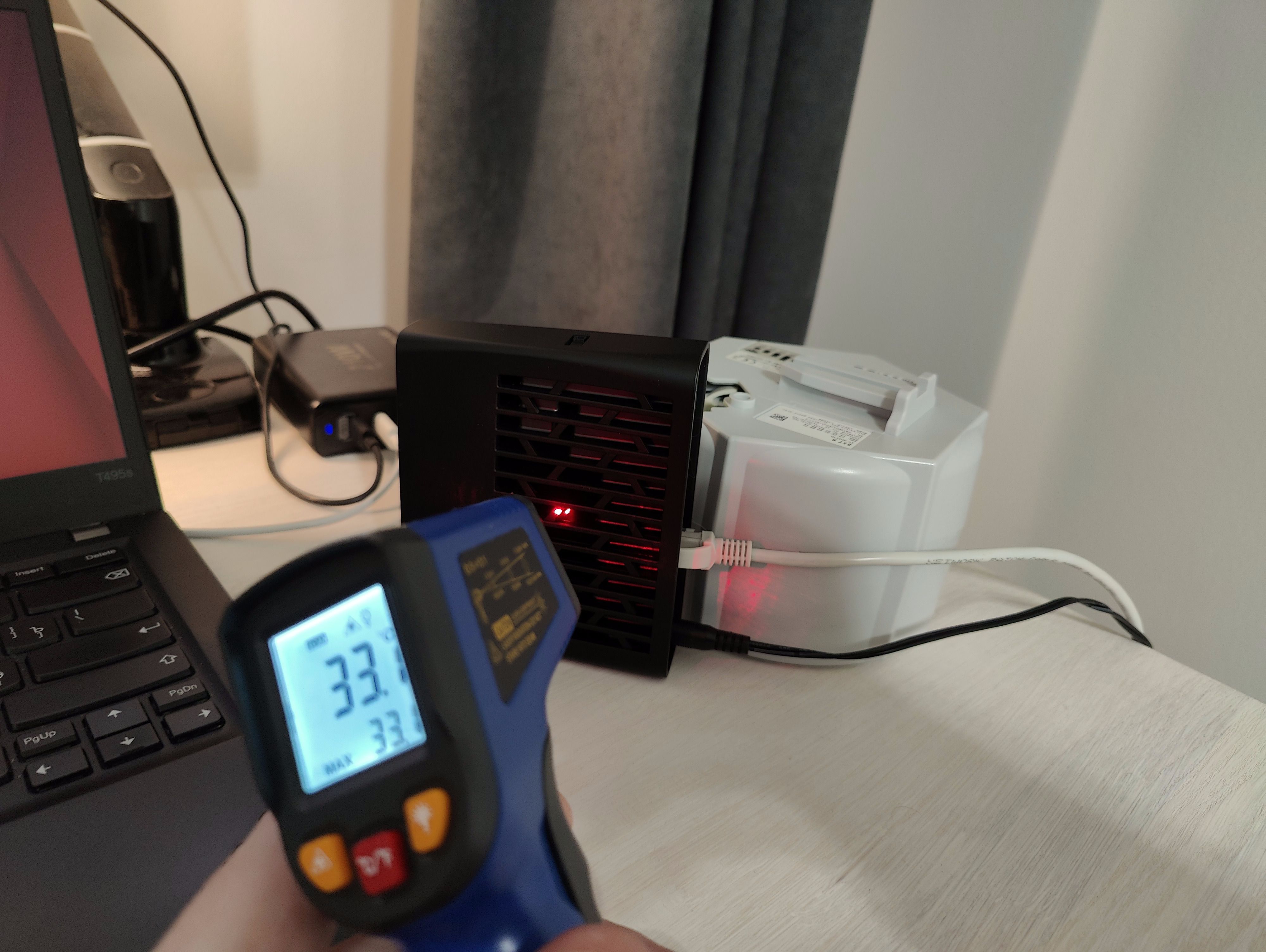

I have SXT LTE6 Kit connected to hAP ax2 ether1 PoE port. hAP ax2 is powered via a stock power adapter.
I was able to reproduce the issue a few times on 7.14beta8 once I turned the device on after storage (at room temperature): no PoE out in both cases (SXT connected to hAP and then hAP powered on; hAP powered on and then SXT connected to hAP).
Then I updated the firmware to 7.14rc1 and could reproduce the issue until hAP warmed up.
Then I put hAP in the fridge for 20 min (its temperature was around -6C, as the pyrometer says) and was able to reproduce the issue again until it warmed up (when the device temperature reached around 30..32C.): no PoE out in both cases (SXT connected to hAP and then hAP powered on; hAP powered on and then SXT connected to hAP). Repeated that twice.
If I connect cooled-down hAP with SXT, power on hAP and let it rest (warm-up), PoE starts working once hAP is warmed up without any interaction.
I did the same test (put it in the fridge) with my second hAP ax2 unit (which works as a home router) - and was able to reproduce the issue. The second unit has a slightly lower threshold, so PoE starts working much faster( in a few minutes of warming up when the device temperature reaches around 12..15*C.
So, both units are affected. Device temperature was measured by the pyrometer in the centre of each device on the ventilation hole side (see the attached photo).

Once more, the reproduction steps:
  1. Cool down the unit [hAP ax2] (-6*C in my case)
  2. Connect SXT LTE6 KIT (eth1) to the unit (eth1) [no other devices connected]
  3. Connect power to the unit
  4. Wait until the device warms up and PoE out turns on. In my case, it’s 12..15C for one unit and 30..32C for the second one.
