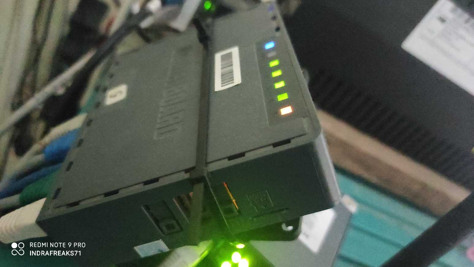

I have a cap ac2 connected on ether-5 on rb760igs. the cap ac2 is powered by the POE of this port (default poe setting is forced on). All was working fine
After power loss today my cap ac2 did’nt power on.
no power on poe out ether-5 on rb760igs (red led not on), but the settings on ether 5 poe show powered on

[admin@RBSUKASIRNAHOTSPOT] > /interface ethernet poe print
 # NAME                                           POE-OUT   POE-VOLTAGE POE-PRIORITY POWER-CYCLE-PING-ENABLED POWER-CYCLE-INTERVAL
 0 ether5-depan                                   forced-on                       10 no                       none
