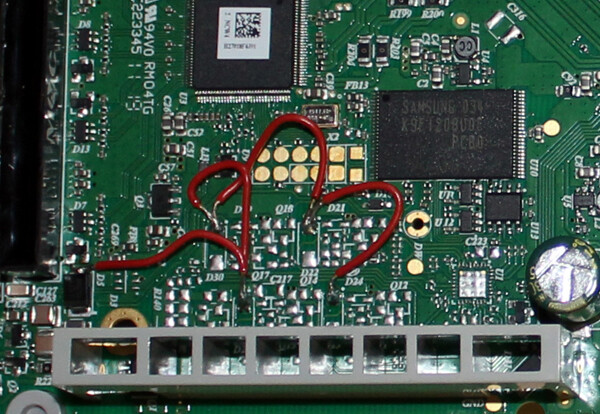

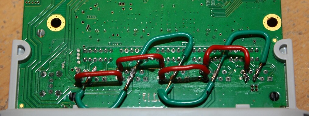

I soldered the POE (looks to the picture) for me is that the best solution to have a stable POE
I am soldering right behind the ports - shorter way is better way for electricity.
Can you made a picture and publisch here please?
yes, these secret settings (that are listed in manual):
http://wiki.mikrotik.com/wiki/Manual:PoE-Out#Global_settings
Here it is:
