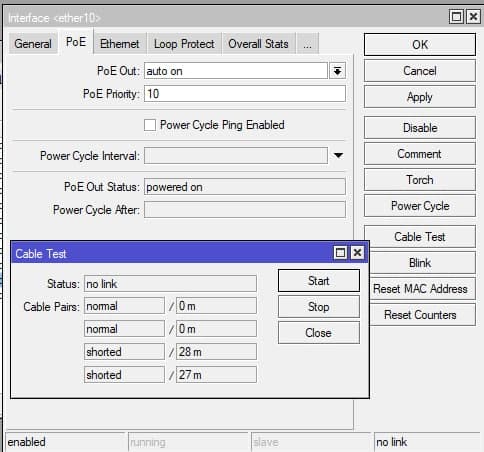

I recently bought RB4011IGS+5HacQ2HnD-IN which comes with POE out on ether10, but when I connect my modem to this port I got no link and modem does not get any power which is working fine with external POE adapter and with pressing Cable test it will show the cable is shorted 28m (cable length is about 29 meter), How could it be shorted when it’s working fine with adapter!?!?!?
I tried forced on and no difference whatsoever. and I really want to use the POE out of the router not an external adapter.
Cable is a CAT6/SFTP 95% about 29 meter long
Image: are shorted blu and brown pairs.
