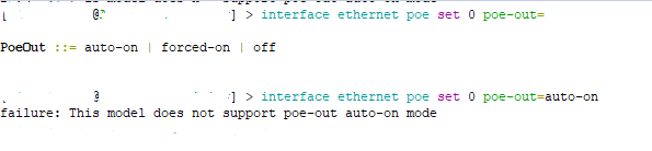

Like I said, it is the exact same model and the first one worked perfectly. As you can see on this screenshot, it offers me the option when I press the (?) key.
Can you set it to forced-on mode? If you can’t do it (or if you can but you want to pursue the issue), then create supout.rif file and send it to support@mikrotik.com
