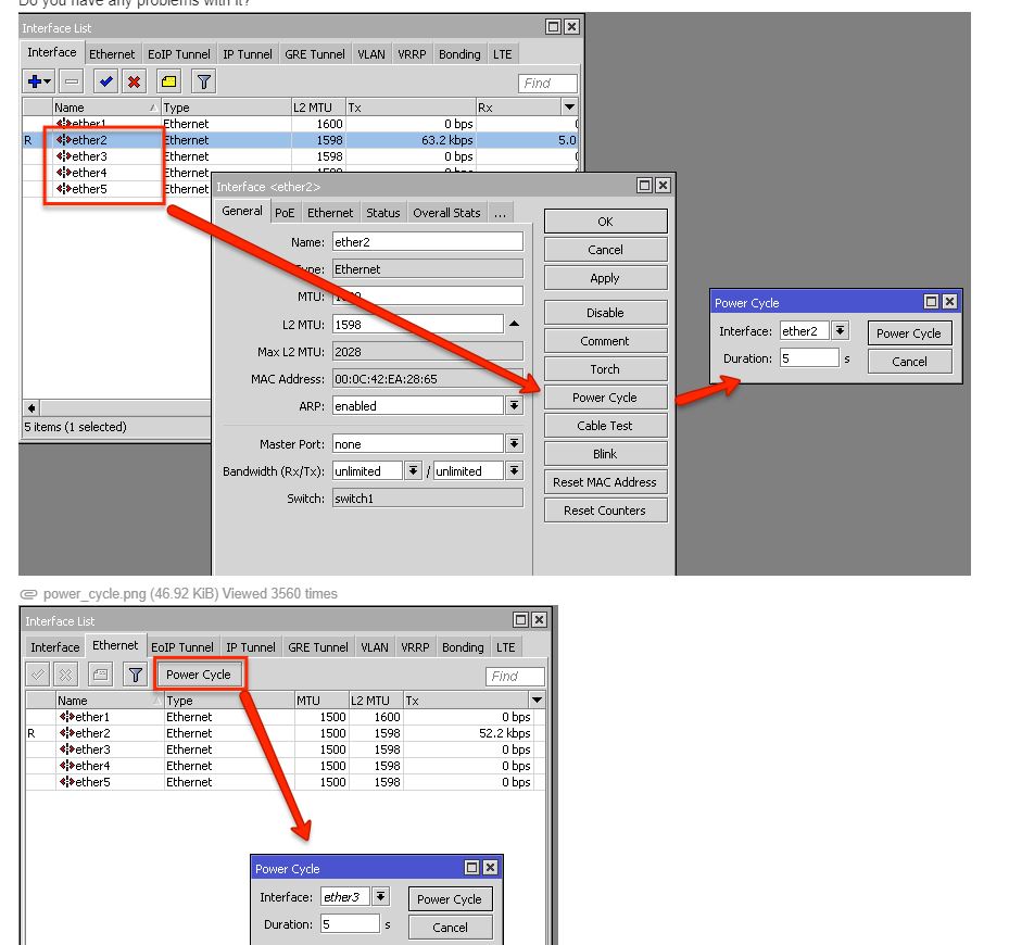

Ive never been able to see or get the Power Cycle command (in winbox) to work (or do anything at all).
ie i should be able to click it, select eth4 , set duration to 5s or 10s, and then poe OUT on eth4 should be set to off, for 5/10s then come back on (to thus power cycle what ever device is getting POE from the MT’s eth4) - nothing happens (ever, ive tried to use this many times, always have to manually do it via poe menu or write a script)

(im talking about this fucntion):
to update: i got a reply from MT support, and they said the only work around is to manually set poe-out to OFF, then back to AUTO/Forced-ON, and they hope to be able to fix the button in a ROS update soon.
