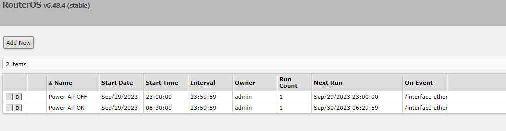

I found the scheduler and i am testing. looks good Thank you !
One question to the “Intervall”
I want to power off or on every da.
defaul valu is
00:00:00
so , for every day it is in my thinking 24:00:00
but this is a invalid value only 23:59:59 is possibly.
set interval to “1d” … or “1d 00:00:00”
