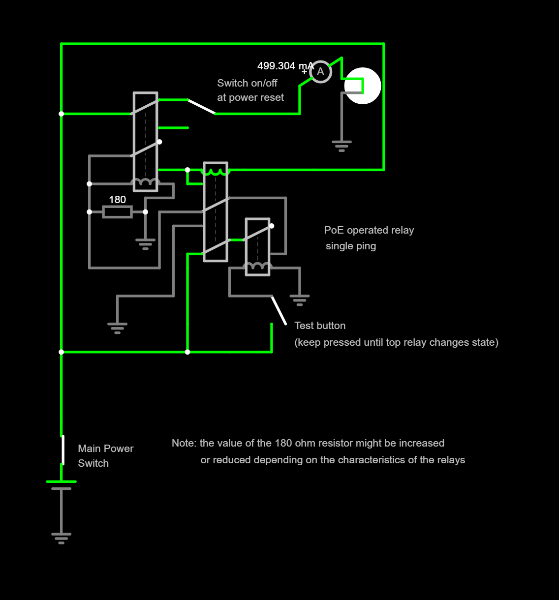

Can you draw a schematic of how this relay is connected?

It doesn’t matter how the relay is connected for be powered from mAP when is forced-on,
but what does it do (the relay)?
Is the contact normally open or normally closed?
What does the contact control?
The relay change power source of the mAP?
Be more specific.
I made a simple test for acu from a buffer power supply :slight_smile:
when I set “forced-on” eth2 the relay cuts off the power supply from the mains and the script periodically checks the voltage from battery. When the voltage drops to about 10.5V (from 12) the test ends and the script changes PoE to “off” and change relay state.
But when I have a broken battery, I have a bootloop, because mAP sets the last state at startup - “forced-on” on eth2 :slight_smile:
The solution is possiblity too set state of PoE after power outage. Mikrotik can do this:) I believe on it :slight_smile:
So you are using the NC contacts of the relay on the (connected to mains) power supply to power the mAP.
Then, when you set the device on “forced on”, you open the contact and power to the mAP comes from the battery (in parallel or enabled from the NO contact?).
When the voltage becomes too low (from battery) the script should set the PoE to off, thus re-enabling powering from power supply.
But if the battery breaks, the mAP becomes not powered, the relay NC returns to its normal state, powering the device (that reboots) from power supply.
The PoE is forced-on as this was the last state before reboot, and thus the power is cut again and you enter into the reboot loop.
Did I get it right?

Rethinking about it, it would make more sense to use a toggle/latch relay.
The mechanical ones are not suitable because they remember the last state they were on when power goes out (battery broken or exhausted), but I believe that electronic ones that default to either on or off at boot do exist.
Electronic experts or enthusiasts will probably have a fit, but there is a purely electromechanical circuit that could do, with two two poles relays, I am attaching it just in case.
The .txt is the file that can be used in the simulator at https://www.falstad.com/circuit/circuitjs.html so that one can play with it.
T_flip_flop.txt (2.17 KB)
