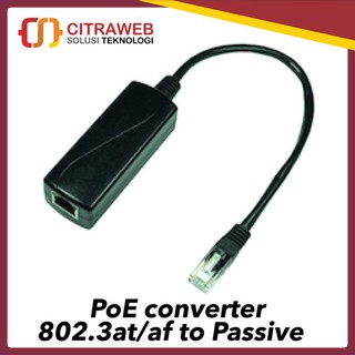

hem maybe you need converter like this
this on Indonesia Distributor maybe you can ask your local distributor https://citraweb.com/produk_lihat.php?id=667
