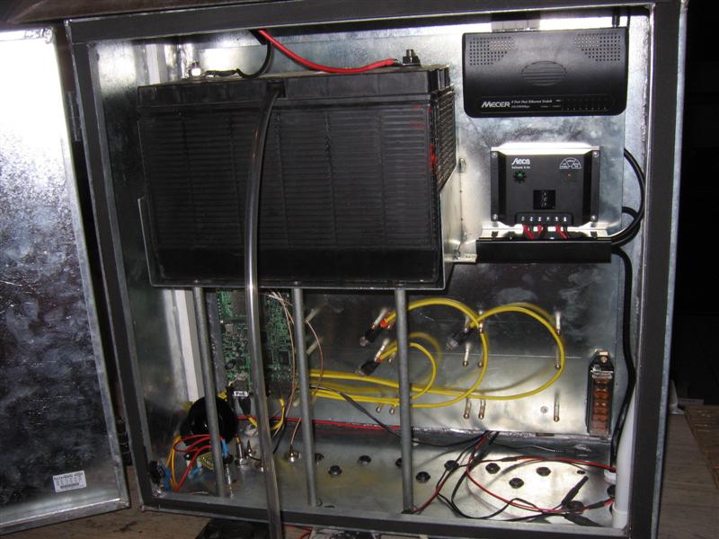

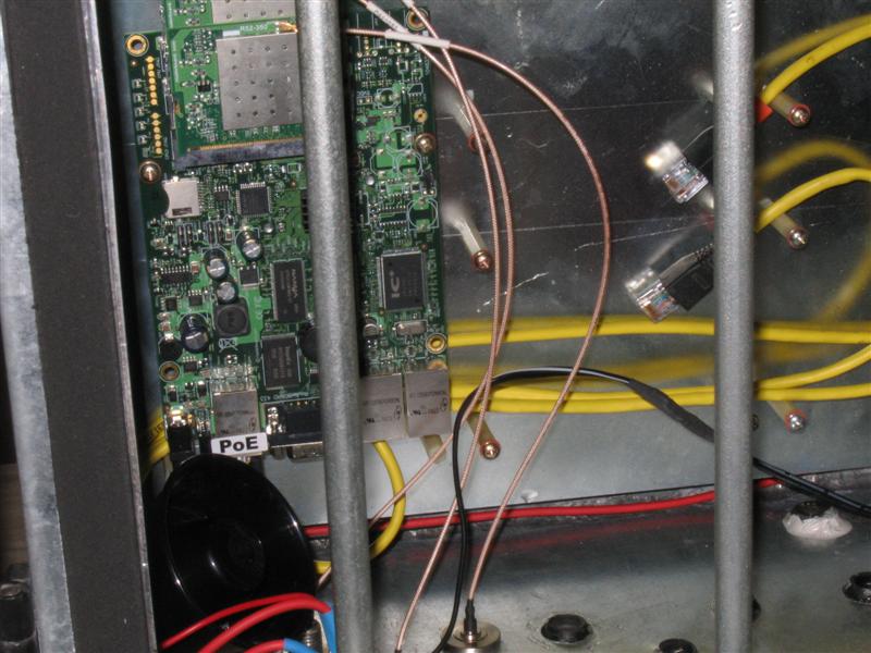

FWIW I run a repeater with 1 x RB433AH and 3 x RB433’s, each with 3 x R52H’s. It’s powered from a single 12V deep cycle battery that’s charged through and a solar panel. I have no issues with 12V. There is no mains power up on the mountain in question.
Here’s pictures of the unit when it was still being tested on the bench.
