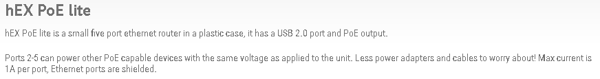

About RB750UP someone knows exactly how many amps per port delivers? I’m a little confusef because the site says two different things(see pictures)… Hex Poe Lite and 750UP aren’t they the same product?? Thanks ![]()
no, they are not the same product
