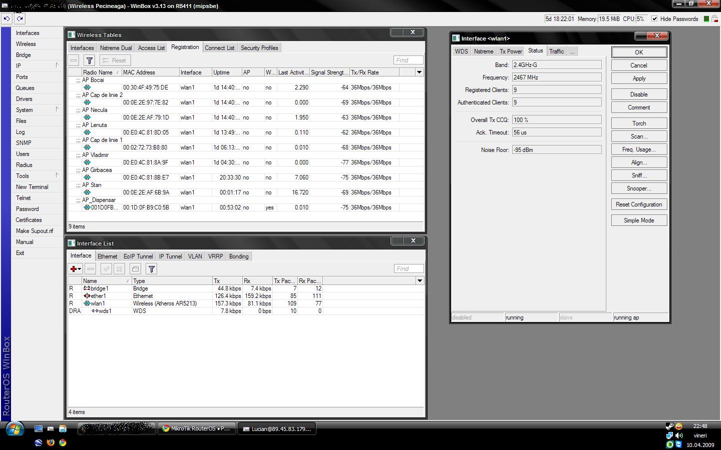

yep…and you can’t do more than 15mbps per sector
as you can see one sector and 100% CCQ
