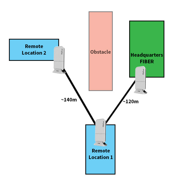

We have 3 locations like in drawing below.
Headquarters have fast fiber connection,
other 2 locations have cca. 140m between each other.
Is it possible to make PtMP links with 3 pieces of wAP 60G like in drawing?
Or we need one wAP 60G AP in Remote Location 1,
and two wAP 60G in other 2 locations?
Also, does anyone have experience with wAP 60G in rainy conditions at distances of cca 140m?
Or suggestion for some other devices for really stable PtMP link at this distance?
Thanky you in advance.
I would use SXTsq Lite60 on the endpoints, they have a little more gain so you have more headroom.
That’s correct. In general for PtMP you need to use a device with license level 4+ as an AP (CPEs can be on license level 3). This is also true for 60G.
