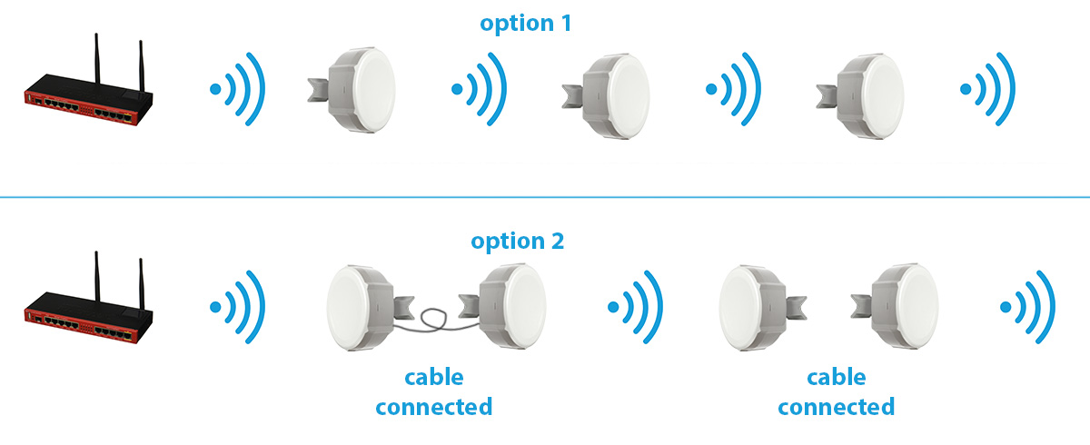

Hello, a really new starter user needing your help! Since i have a large space to cover with wireless i bought 10+ routerboard SXT 2 and the main idea is to connect them to work like a chain wifi extenders. (I hope i’m explaining it well) So my question is, what mode should I use for this and how to connect all of it to work and have wireless connection on all of them. In the attachment is my scheme of my idea, the first option is the main idea, but since people told me that its not recommended to connect more then 2 i need some better option. Sorry about my English.
Both options are bad, but the second one is still muuuuch better.
Ideally you need separate radios for PtP backbone and for serving clients.
Ok, well… what is the best option to achieve my goal? Is there any tutorial i can follow to get things done.
There is no universal solution.
Too many factors: inside/outside, distances, obstacles, number of clients, uplink speed, neighbouring network, etc.
And the best option can be found only after at least basic radio analysis at the location.

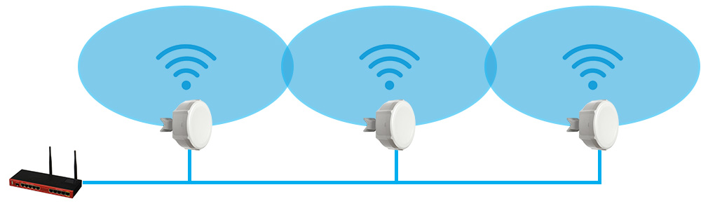

Is this better option then? One ssid, one wifi of course.
Sure!
If you can connect all the APs by wire it will be the best and the easiest solution.
Only thing to keep in mind - use different non-overlapping channels on the adjacent APs.
