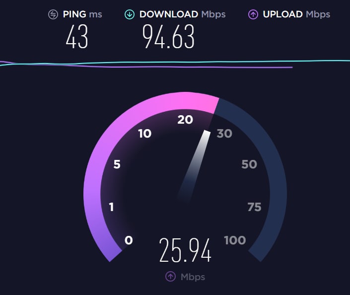

You mention “LTE” word and I am here too :).
I must say that Directional antennas are great for P2P LTE… and to get proper speed people do stange stuff :slight_smile:

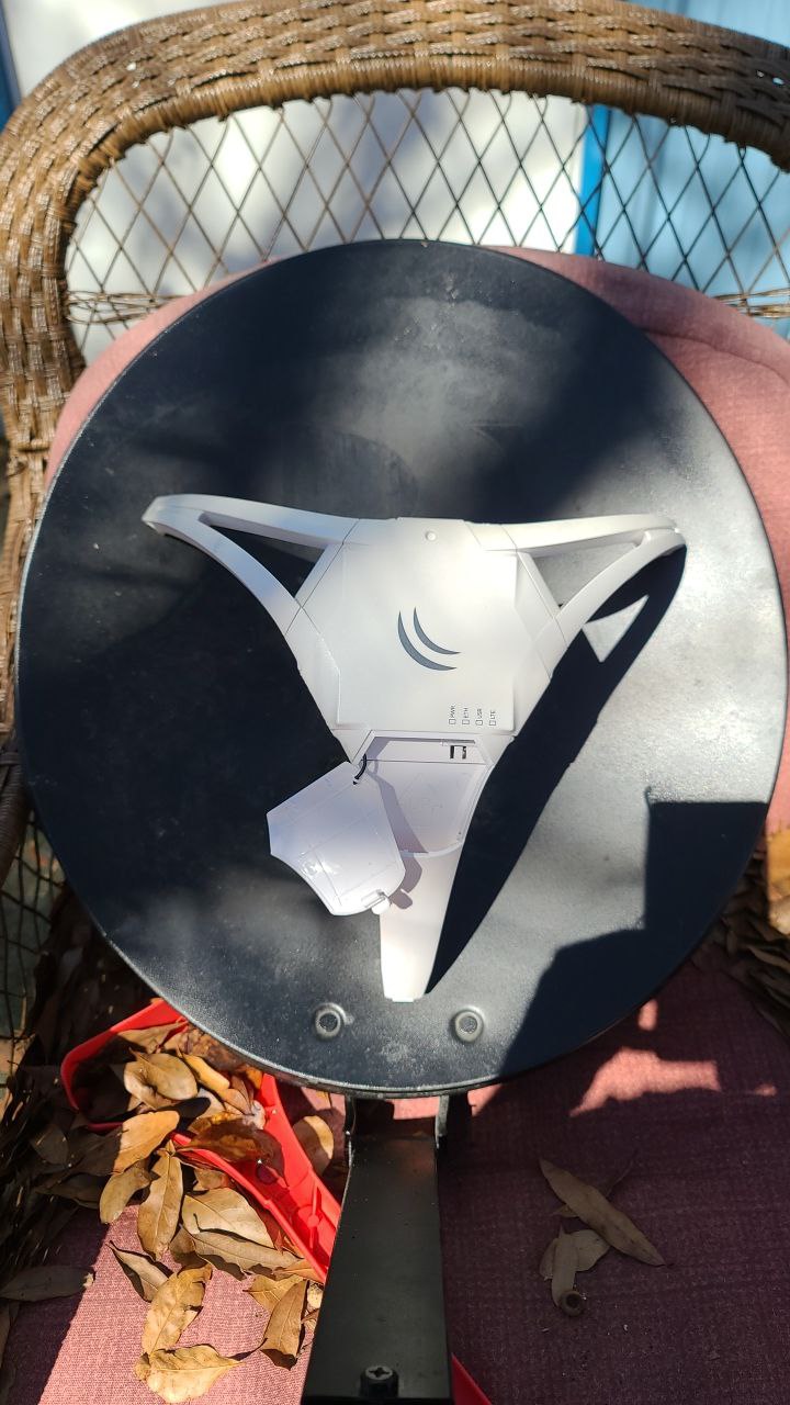

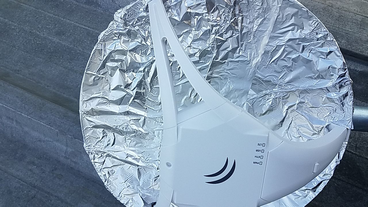

Aluminium… not give better Gain. Even when we use proper FLAT Tape.
But this plastic back you can replace with 40cm 18" small tv dish - this is perfect and works perfect :slight_smile:

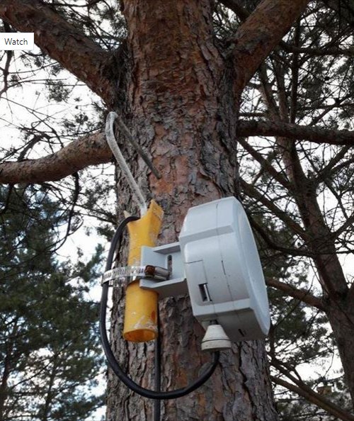

‘Top student’ must climb high tree to take online class
Distance learning, all well and good, but in Siberia it can present you with unexpected challenges. Because his remote village receives only a 2G signal, 21-year-old Alexei Dudoladov, a student at the Omsk Institute of Water Transport, has to go 300 meters into the forest each time and climb an eight-meter-high birch tree.
