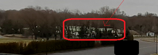

Hi. I’m new here, hello everyone. I have a huge request. I have a wireless connection to make between two buildings (as in the photo, the second building is marked in red). Distance about 350-400 meters. There are trees on the road between the buildings, not many of them, but they are there. In summer, the trees will grow overgrown with leaves. Is it possible for a point-to-point wireless connection to work? The connection can be at the level of 50Mb / s both ways.
If the connection should work, what Mikrotik devices would be best used for radio communication?
Thanks for your help and answers.
Is that building to the right also part of that “property”.
Shoot the signal over there with a pair of Wireless Wire Cubes.
Then do it again over to the main building.
Here ------- Here
Here
I thought about it. Use this cottage as a wireless transmission point. But I can’t.
