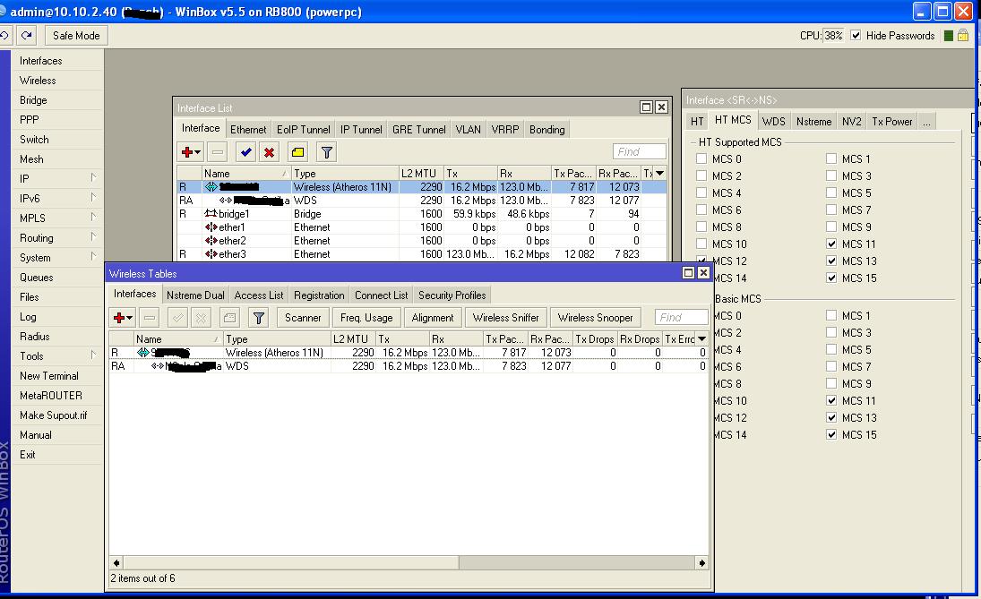

This is my link 20km
All is on default only data rates I set manual
This is actual Internet traffic but it last only for 5-10 min (Or I don’t know when data rates will drop <104mbit on the photo are now tx/rx 216/216)
