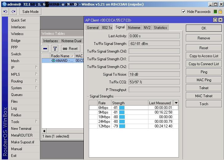

Hello
Thank you , done this changes, but the signal status is attached can you any one help how can i improve it
Regards
you need to somehow improve your CCQ more to 100% the better, this could be achieved by increase / decrease the power, but looking at your signal strength i would imagine it needs either more height or some obstuctions out of the way,
hope this helps ? lol
