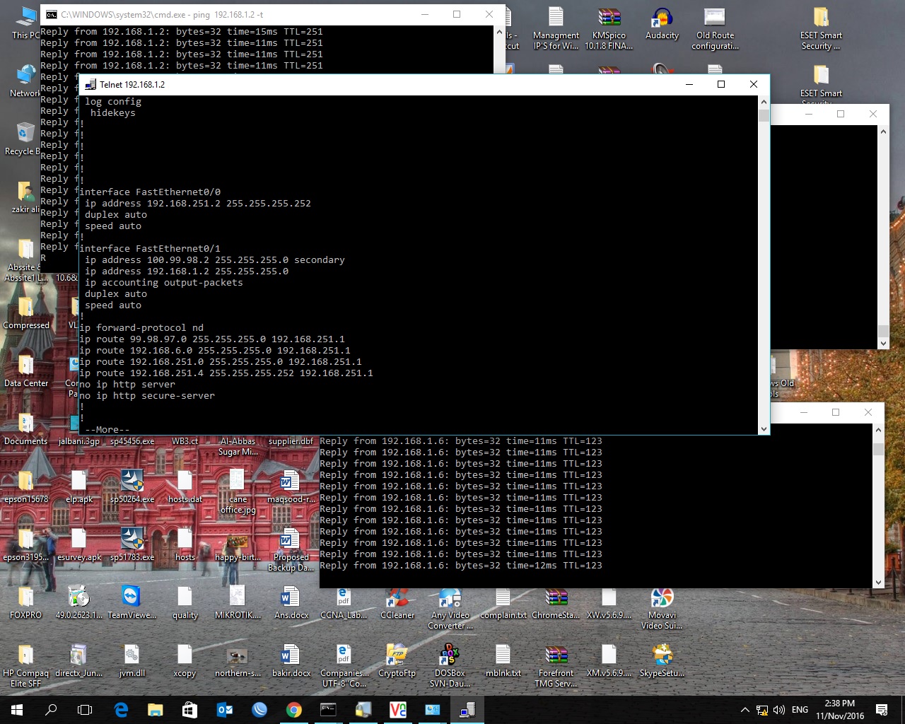

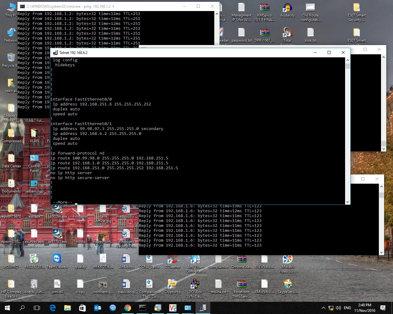

Dear Friend;
i added two images of my old network’s routing and I.P settings and it will show you how i had performed Routing in CISCO 2811 Router and same is the scenario again but the only difference is that this time i am trying MikroTik Router RB1100AHx2 instead of CISCO 2811 at location ( Router Site.jpg ) so please dear check the images clearly and could you rectify what’s happening here while i also tried using same I.P 192.168.6.2 of my old network but it does response only 192.168.1.0/24 Pool only and it does not 192.168.30.0/24 Pool meanwhile in old scenario both pools were working fine..
Thanks in Advance..

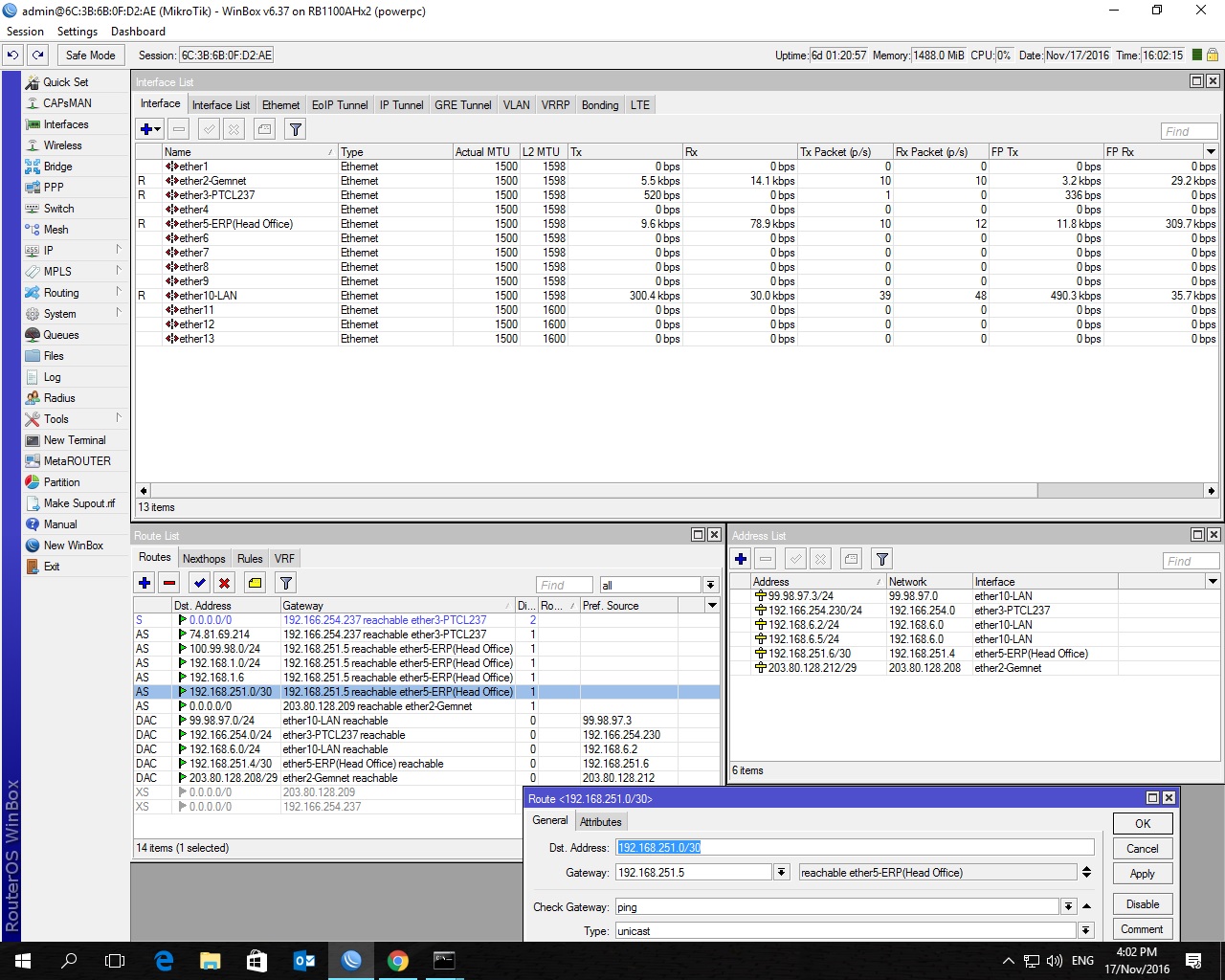

I have seen the image for the cisco config and how it’s working. Are u replacing Mikrotik with cisco are you trying to implement same in another site? In any case can u also send the interface for the Mikrotik so i can also see where things went wrong. ?
Dear Friend
ekpesinyang;
attached is my environment at MikroTik router side and yes i have replaced only one end with MikroTik router meanwhile on my second end i have still CISCO 2811
previously they were working further you can see the images which i have added in reply to someone’s post.. routing and I.P’S were clearly defined there..
hope you can understand the environment
