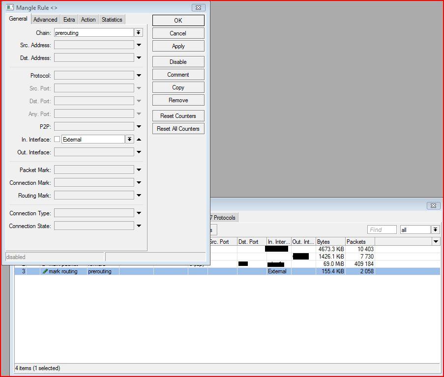

3 chain=prerouting action=mark-connection new-connection-mark=External passthrough=yes in-interface=External
4 chain=prerouting action=mark-packet new-packet-mark=External_pack passthrough=yes in-interface=External connection-mark=External
5 chain=prerouting action=mark-routing new-routing-mark=External_route passthrough=yes packet-mark=External_pack

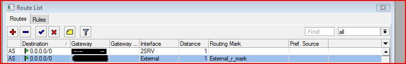

And in routing
1 A S 0.0.0.0/0 reachable routeriphere 1 External
And this has the routing mark External_route
*Note all Counters for the connection mark/packet mark & routing mark is counting as traffic hits the interface…

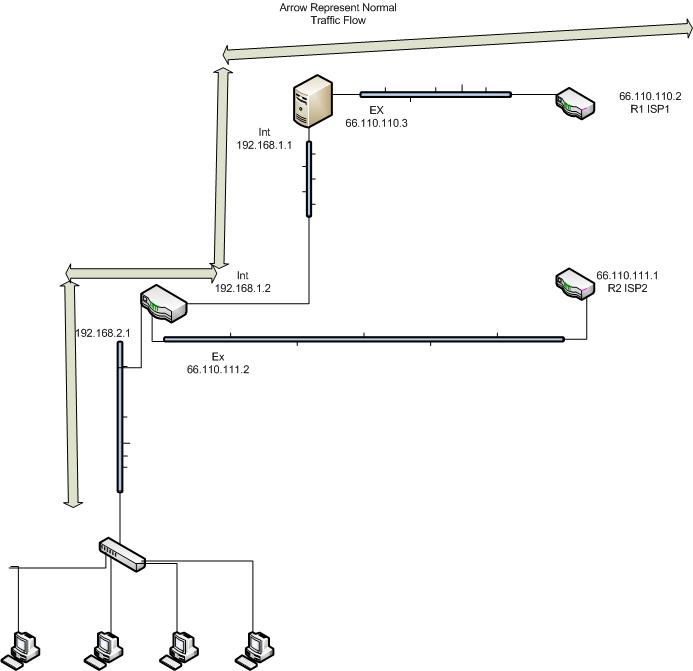

First off please forgive the really crass way i had to depict this…
Seems my visio 2003 didn’t want to work on vista, very odd..
Here is a very bad hand-drawn pic of how the setup looks…
Now:
*The Mikrotik can ping R2 as it’s on the same network
*Hosts on the internet can ping R2 but not 66.110.111.2
*Let’s say for arguments sake i want to access the web interface Mikrotik provides on the 66.110.111.2 address
*The normall flow of traffic is from the PC’s to the Mikrotik, to the server, which in turn NATS the traffic using 66.110.110.3 as the external IP.
*Both Server and Mikrotik Run OSPF however default routes are static
*Default route on Mikrotik is 192.168.1.1, so ALL traffic with unknown destination end up at the server.
Suspicions:
Traffic comes in through R2 and is able to reach the Mikrotik router however because no other routes exist for hosts on the internet , it uses the default route sending traffic to the server for the replies breaking comms.
I have tested by specifiying a static route to my system at home to go to the R2 router and comms works fully.
Thus the need to use policy based routing to ONLY route traffic to R2 as the default gateway , IF the traffic originated from it in the first place.

I tried all variations, now ive gone back to my original setup as per mikrotik guides.
The Default route for all Routing marks “External_r_mark”
The mangle rules marking the packets.

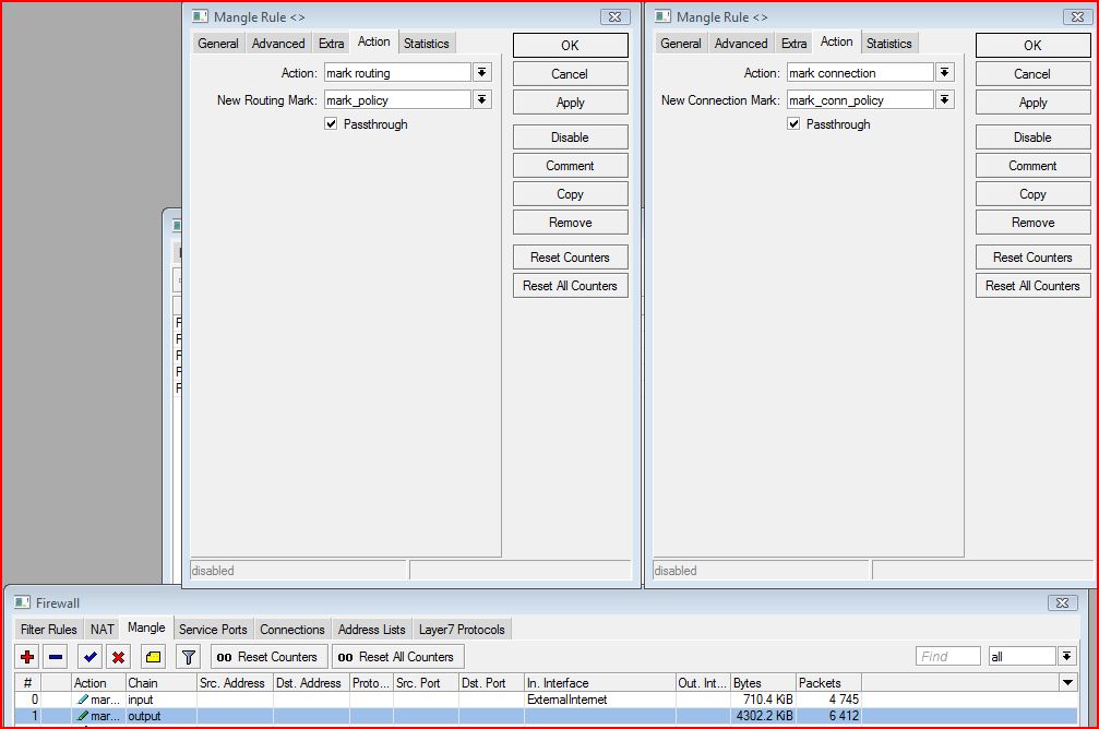

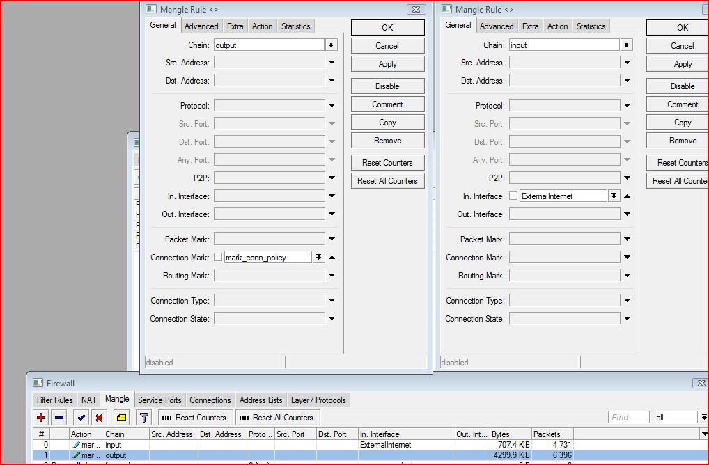

Solved it…

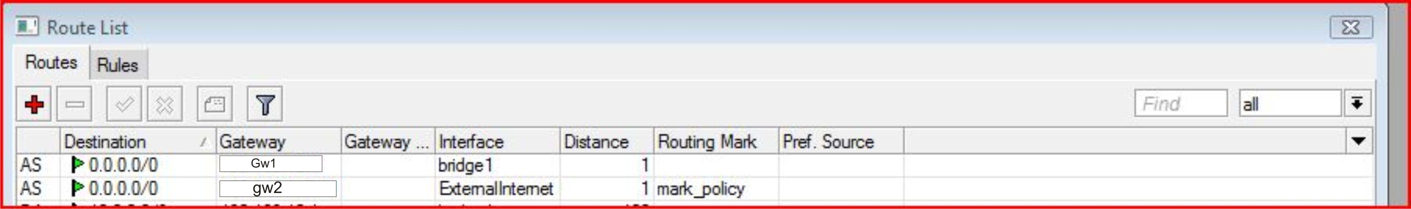

It can be achieved easily:
  1. mark all necessary connections in mangle chain INPUT (specify in_interface, dst-address etc)
  2. mark all packets (with routing mark) from this connections in the mangle chain OUTPUT
  3. create a default route for this routing mark

[quote=“thavinci”]Solved it…
Like you said …
/ip firewall mangle add chain=input action=mark-connection new-connection-mark=conn-mark-isp2 passthrough=yes in-interface=isp2
/ip firewall mangle add chain=output action=mark-routing new-routing-mark=routing-mark-isp2 passthrough=yes connection-mark=conn-mark-isp2
/ip route add gateway=ISP2-GW-IP routing-mark=routing-mark-isp2

Don’t know if you still need that example, but here is screen shots of how i do it.
100% fully working.
Lemme know if you come rite…
