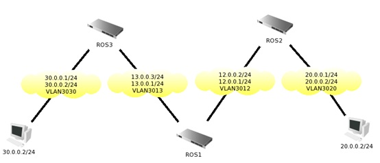

In this topology
ROS1>/ip add address=13.0.0.1/24 interface=vlan3013
ROS1>/ip add address=12.0.0.1/24 interface=vlan3012
ROS2>/ip add address=12.0.0.2/24 interface=vlan3012
ROS2>/ip add address=20.0.0.1/24 interface=vlan3020 (gateway for pc 20.0.0.2)
ROS3>/ip add address=13.0.0.3/24 interface=vlan3013
ROS3>/ip add address=30.0.0.1/24 interface=vlan3030 (gateway for pc 30.0.0.2)
We need 2 PCs can connect to ROS1 for ping or winbox , but ros1 just config address to the vlanif , don’t have route to PCs
If could not add PCs route to the routing-table, we just can ues the policy-route to do “source in source out”

There is no bug, a destination must be resolvable in the main table too.
