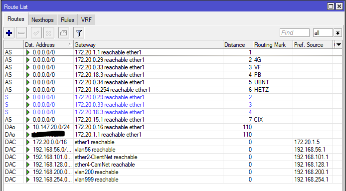

Here’s an example of mine. First is my default routes. You can see I have some of them duplicated with a routing mark:

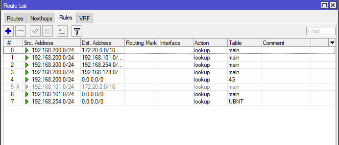

At the moment I only have two routes with a policy applied (marked as 4G and UBNT) and you can see how I set the source:

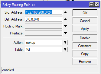

Here’s what it looks like. Mine is a subnet but it can also be a single IP address.
Destination can be what ever you want it to be as well. A Subnet, An IP address etc. In my example you can see that traffic from subnet 192.168.200.0/24 gets routed through gateway 172.20.0.29 instead of the default gateway 172.20.1.1
It’s a much simpler solution than messing about with Mangle rules.
