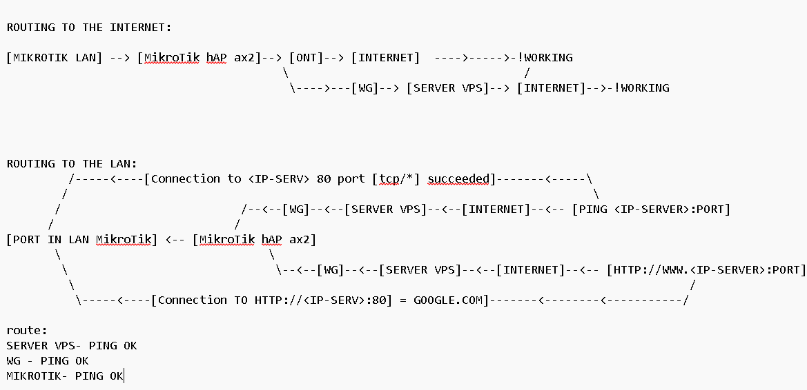

Policy routing on HaP ax2 fails (VPS-LAN)
Hi Im looking for working NAT rules for HaP ax2 ROSv7.20
Thanks for any suggestion

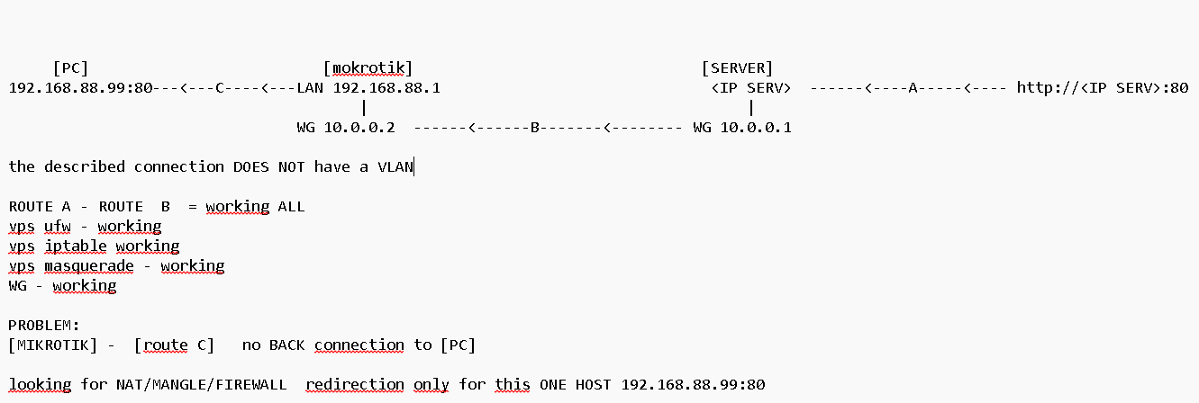

Separate your diagrams into digestible components.
A. network diagram detailing vlans, internet connection etc..
( for example it would appear your talking about two different routers talking to one another over the internet??)
B. To discuss traffic flow
  • identify all the user(s)/device(s) including the admin
  • describe the traffic they each need to accomplish
like tis?
If you want the PC to reach the server via wireguard, then recommend sourcnat out the wireguard on the mikrotik
add chain=srcnat action=masquerade   out-interface=wireguard1
This will solve most routing, and allowed addresses type issues at the VPS end,
and this also assumes on the mikrotik, the allowed IPs is set to either 0.0.0.0/0 or at least
10.0.0.0/24,vps-ServerIP
If what you are asking, is how do I force that PC out the wireguard tunnel.
/routing table add fib name=useWG
/routing rule add src-address=192.168.88.99 dst-address=vps-serverIP \
    action=lookup-only-in-table table=useWG
add dst-address=vps-serverIP gateway=wireguard1  routing-table=useWG
If the intent were for the PC to reach the server and to go out the internet at the other end it would look like:
/routing rule add min-prefix=0  action=lookup-only-table  table=main
/routing rule add src-address=192.168.88.99  action=lookup-only-in-table table=useWG
add dst-address=0.0.0.0/0  gateway=wireguard1  routing-table=useWG
NO …i ask HOW to reach to [PC] from [MIKROTIK]
using the Internet connection http://[server ip]:80
because the connection from [PC] to the [INTERNET] works well
I put arrows in the pictures DIRECTION OF CONNECTION :wink:
Why would the mikrotik need to reach a PC on one of its subnets???
Its local and knows where it is.
If the information was clear, I would not be lost LOL.
Try a different network diagramming method.........

you know it, I know too... BUT MIKROTIK doesn't know it.
I got a suggestion that I must try another MT ROUTER to test my configuration...maybe THIS router have some problem :thinking:
