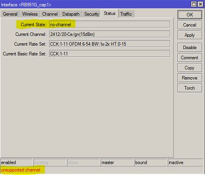

When i try to type in 40MHz it does accept it, but the CAP-Interface (i.e. the Accesspoint) gives me an “unsupported channel”. :frowning:

I had to use 20MHz anyway, because 40MHz was throwring an error. :wink:
