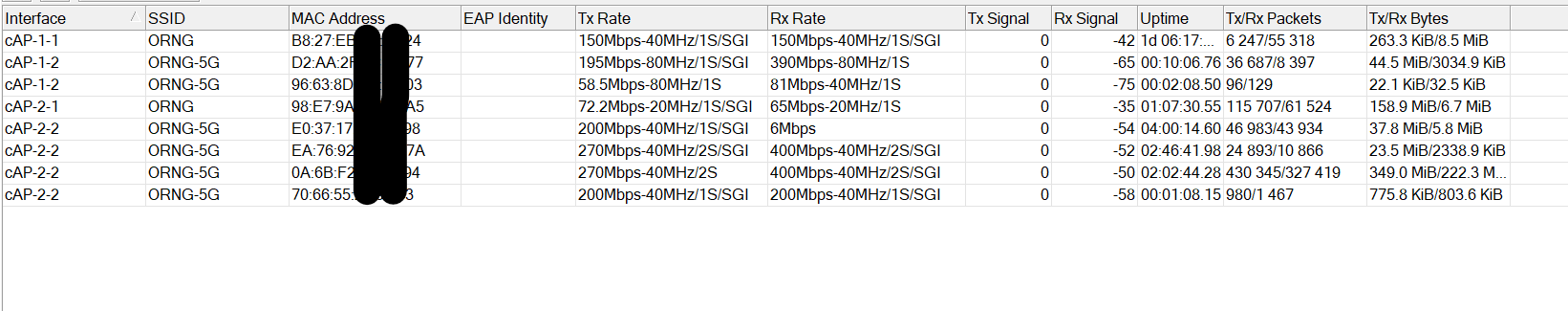

Here is the rates from Registration Table of CAPsMAN:

From the client overview it seems that the 2.4GHz channel is set to 40MHz (extension channel), though your config looks fine. Can you please check that?

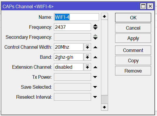

Done, Changed to channel 6
for the channel width of 2.4Ghz, this is how it looks as of now:
You should set Extension Channel to be disabled.
On 2.4G or 5G?
Disable extension channel for 2.4Ghz.

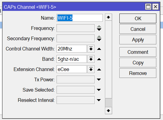

For 5Ghz provisioning can use XXXX extension [if you setup auto frequency list].
I would always advice to set fixed frequency and fixed extension channels. That is the only way to ensure what is happening in your wireless network (apart from channel swaps caused by radar detection).

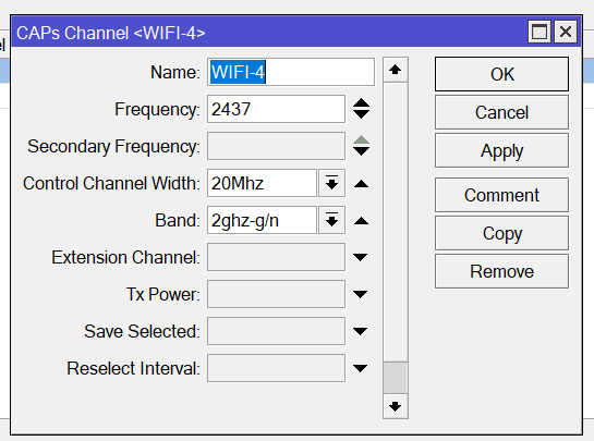

I Guess I have it done correctly?

No clue on how to set up auto frequency list, please help?
Everyone asks the auto frequency list question but nobody answers it.
In frequency, enter a frequency and click the down arrow and enter more frequencies. That’s it.
