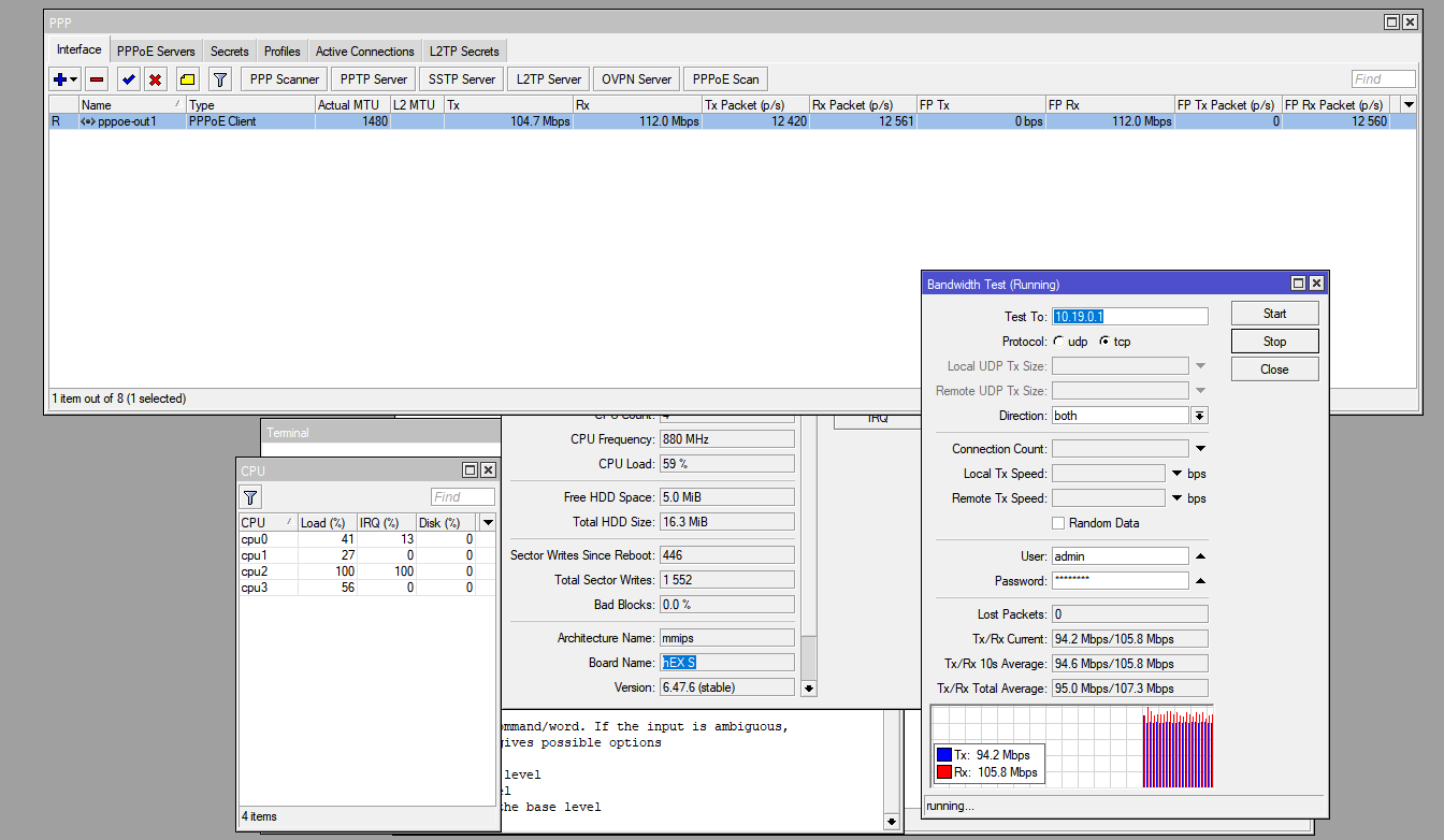

As you can see in this img the test show only ~100/90

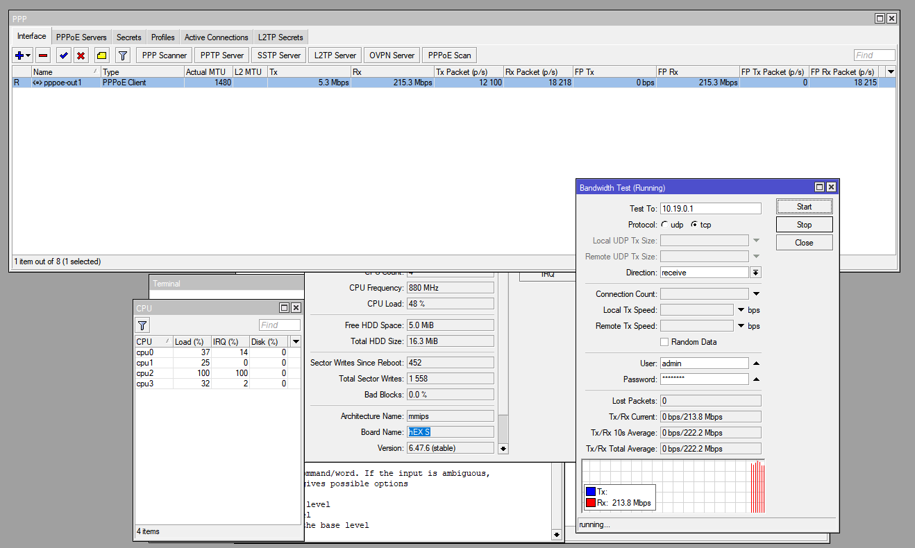

And this one 200 as is one side

OP is getting more than what you predict: he’s running bi-directional test and getting 95Mbps Tx + 105Mbps Rx … in uni-directional test he’s getting around 220Mbps. And I guess (based on same rule as @Anav) that this is it for the bucks …
@Sergiu, just to be sure, you can run CPU profiler to see CPU load and which particular process consumes most of it.
