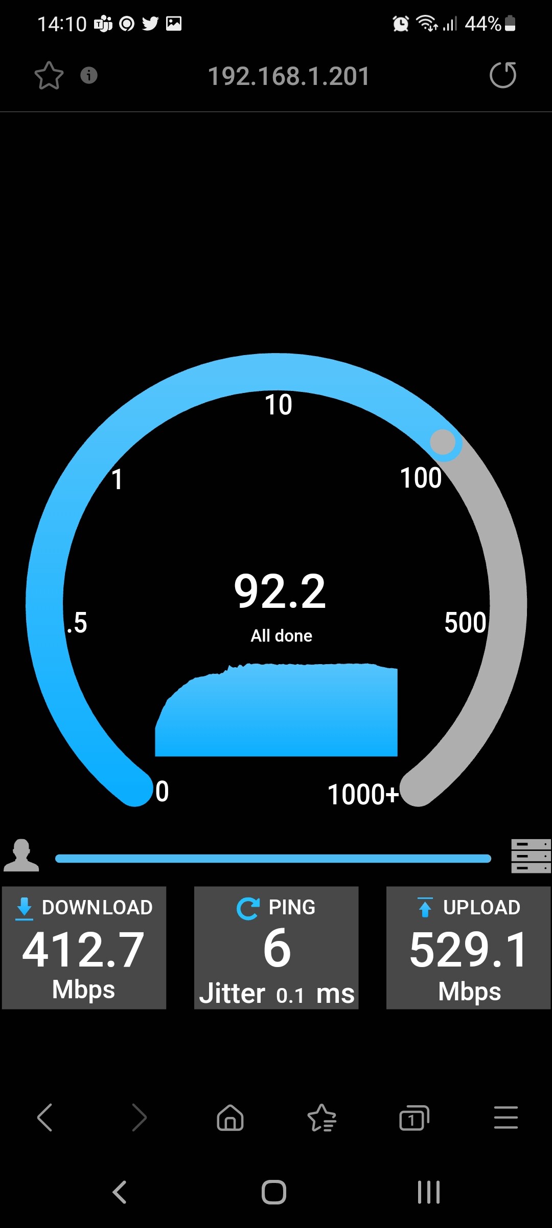

I’m getting 400mbit download and 500mbit upload 3m from wap ac or cap ac via capsman in local forward, connected to samsung s21 for example.(using local test server)
80mhz, n/ac, nothing special confing…
Capsman is on v7.2RC3 and caps on v6 long therm.

Very interesting seeing that the advertised 2 way speed of a capac is 867 and thus one way the theoretical max possible BEFORE LOSSES is 433.
Not saying your a bold face liar but I dont think your testing setup is credible.
A 2 way speed? What are you even talking about I hope you didnt understand that I get this both way same time? I can record you ap, laptop and wifi interface of ap inside winbox doing this bandwidth on video if you don’t belive.
@anav, you’ve got this wrong. WiFi is time-division duplex, which means traffic can flow only in one direction at any given time. But nowhere is limited to divide uplink and downlink in equal ratio (which is what you’re saying). In contrary, since WiFi is using random access (and optionally RTS/CTS), it is possible to use almost 100% of air time for one direction. For TCP transers the return direction only needs around 2% of bandwidth (for ACKs), which might translate into 10% of air time. But that still leaves around 90% of air time for “busier” direction, which may mean around 790Mbps gross throughput.
