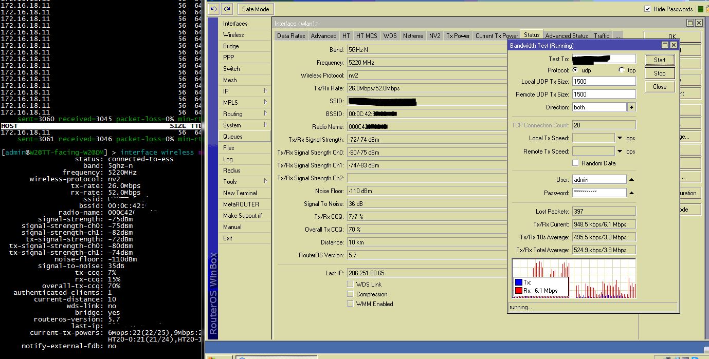

I have currently set a 10km PtP link with two RB433 boards each fed with the R52Hn minipci cards to ubnt rocket dish 343bi
unfortunately i cant even get 10mbps down and 10mbps on the link. I see people are posting 150 and 300 mbps for over 14km and 50km here.
I presume am doing something wrong.
what is the significance of “current-ofdm-errors” ? which my own keeps rising 11615
or could it be the choice of radio cards (i have R52HN). if they are not good should i consider the DBii F52N-PRO or the UBNT SR71-15 minipci cards
please find screenshot of client side radio stats attach

Are you kidding! get those signal levels sorted out first! Maybe your antennas are not aligned! Without using a calculator and based on experience alone, I would say that you are 20-25dB short on signal.
Do you have one of the antennas with chains crossed over.
Its crossed over and the noise levels are very high, try another channel, do a frequency usage scan and use the less usage channel

most certainly i too see some alignment issues in ur link …10 km with 32dbi grid antenna should be around -55 signal or check ur pigtails.

I don’t understand: -110 dB is a high noise level???
All my antennas have -110 dB what is - i think - the detection minimum of the cards. They are working fine.
Please explain where you see a high noise level!

The signal levels might give the conclusion it is cross connected (what is H-pol is connected to the V-pol part of the antenna on the other end and vv.).
I don’t understand: -110 dB is a high noise level??? All my antennas have -110 dB what is - i think - the detection minimum of the cards. They are working fine.
No, he made a mistake here. -110 is very low. SNR is also good so that’s not the problem here.

But in general the signal levels are verly low. That could be much better. And if signals on both ends for all chains are in -40 - - 65 range the high througputs as shown by many are indeed possible, specially with NV2
