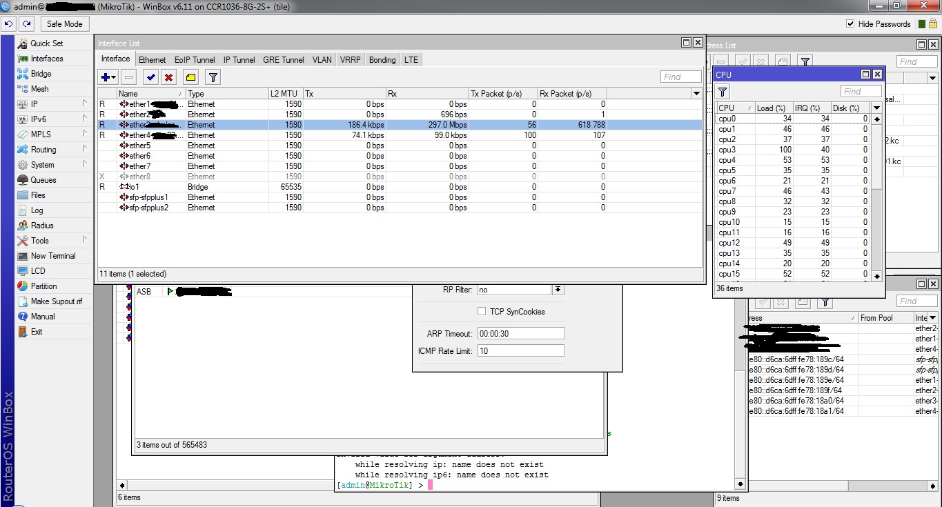

We have 2 CCR’s in production right now, running ROS v 6.15, and when we receive DDOS traffic to hosts on our network in the 600k PPS range, we are seeing %50-75 CPU usage. At 1G, the systems lock up and restart. IF the systems are supposed to route many millions of packets per second, then I’m thinking we have it configured wrong. Perhaps fastpath might be off? There are no firewall rules or queues, and the interface queues are set to hw-only.
Any hints on getting these to work as advertised?

Part of this is probably also the fact that it isn’t forwarding these packets but rather having to dump them, and that can be costly since there is no fastpath entry etc for them so you’re processing 600kpps in software essentially.
The lack of outbound packets is via a null route (blackhole), not a firewall rule, so I would think the fastpath should still work. The CPU usage was double what it was in the screenshot prior to the null route being added, so even if a blackhole avoids fastpath, it still wasn’t forwarding with the expected performance piror to the null route being put in place.
