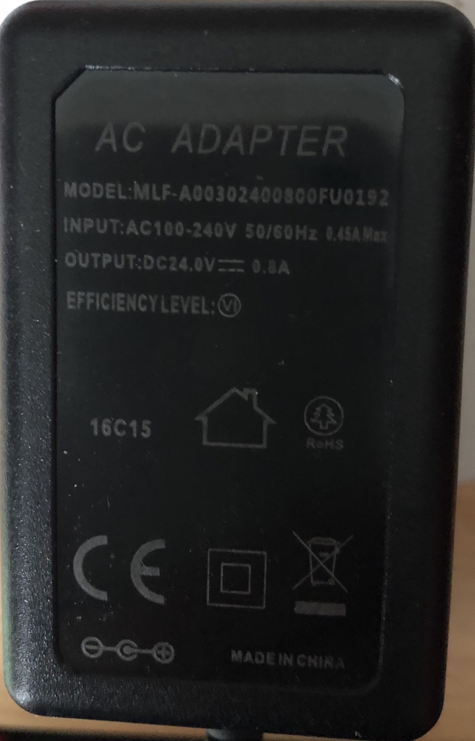

I purchased two SXTsq 5ac units in the UK (from wifi-stock.co.uk) and they were supplied with a UK version of the power adaptors (with the UK 3-pin mains plug connection).
Unfortunately I’ve had 3 power adaptors that were supplied with the SXTsq 5ac fail in a very short time of use. They were plugged-in to stable mains power sources none of the other equipment connected next to them have had any issues.
It’s really quite disappointing that something so basic as the power supply unit is causing me so much grief. As I’m just an end user I don’t have spares laying around so with each failure you can imagine the situation of having to get a replacement, the costs and the down time.
Are the power adaptors really bad quality or have I just been unlucky? Should I be looking to use an alternative like the 24V Ubiquiti gigabit version with the built-in injector instead of the Mikrotik gigabit injector cable and power adaptor?

I believe it can be RMAed, but you most probably have to return the whole unit to them. I’ve bought a bunch of replacement 3rd party supplies and just replace them when they fail..
Unfortunately wifi-stock in the UK told me the power adaptors are ancillary items and not covered by a warranty and only the radio itself would be covered. They told me they’ve tried to RMA adaptors to Mikrotik in the past and they would not accept them. Quite disappointing and unfair really, especially as I would consider the power adaptors to be a critical component for the unit to work and there is also the cost factors every time one fails. Over the years I’ve hardly had any power adaptors fail that have been supplied with CPE hardware, etc, so I’m very surprised (and actually quite shocked) how poor these one have been.

(BTW: I tried to see if I could reduced the display size of the attached adaptor pic in my earlier post but couldn’t find any obvious way).
