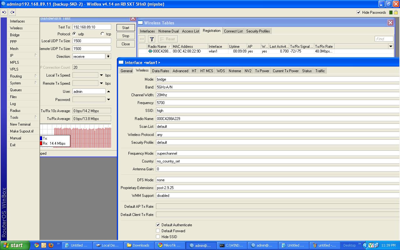

  1. Your signal (-72/-75) is not that good. It should be-60 to -65.

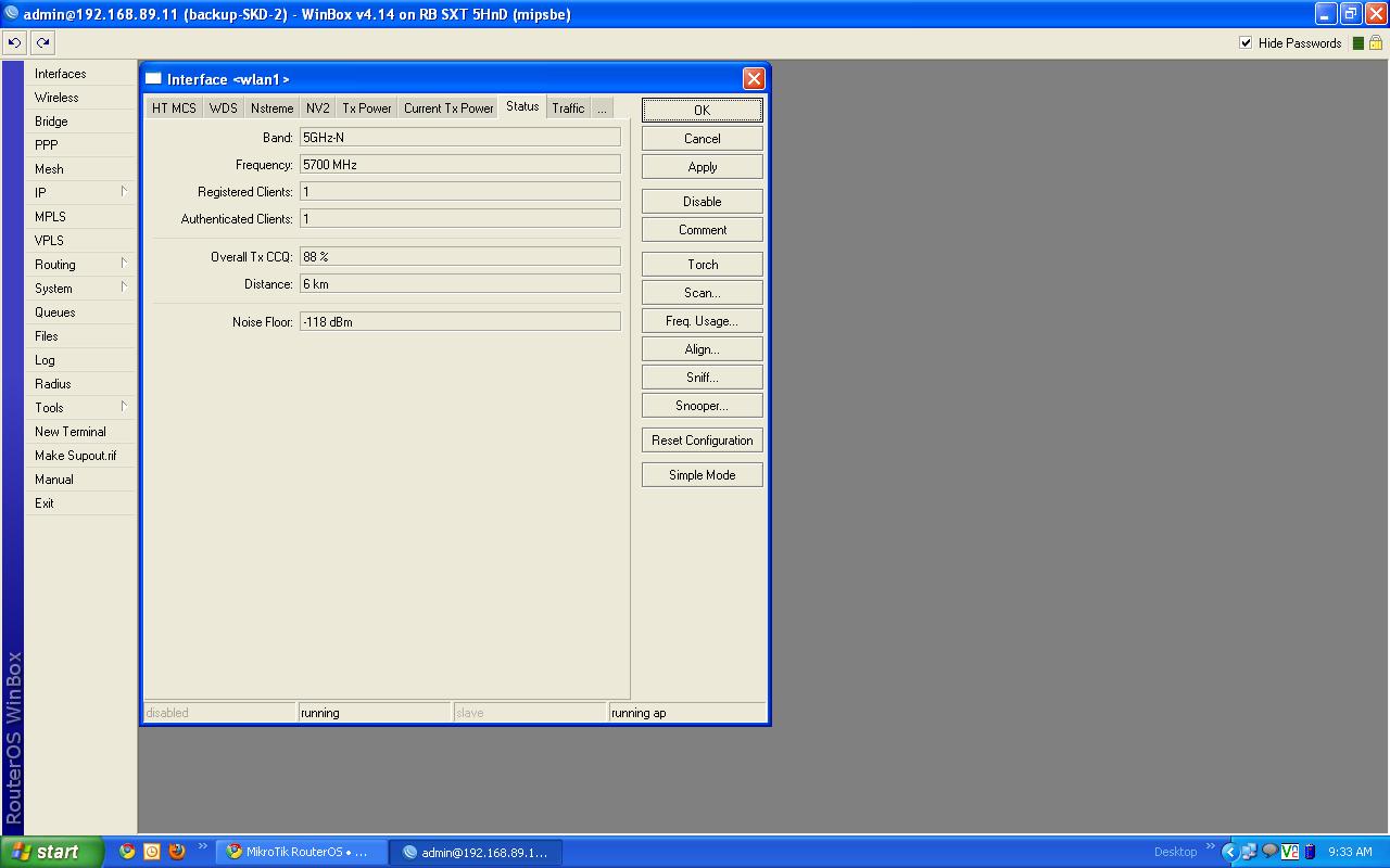

  2. You don’t show us the SNR and CCQ.

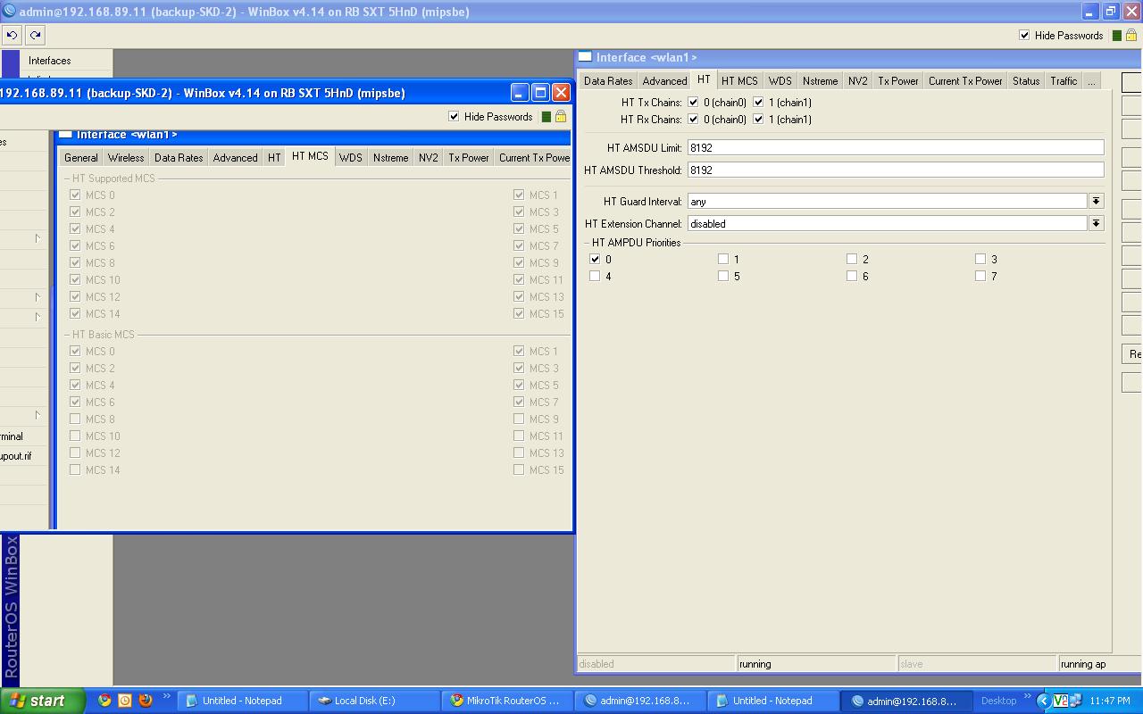

  3. Try enable HT Extention Channel → below control
  4. Enable nstreme (with framer policy=best fit and framer limit=3200) or NV2.

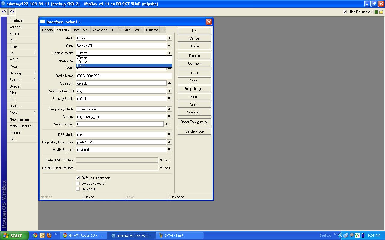

Try to use 40MHz channel width instead of 20mhz!
i have set extension channel to below control but result was same.
here is my CCQ reoprt
thx
but from where i can get 40 MHz enabled, i dont see this option in my SXT

when i set both of these to NV2, the link between these is completely lost, and i cnat see any signal in registration TAB. i have tried various frequencies and line of site is perfect.

Oh sorry! I didn’t know that the SXT did NOT support 40MHz channels, but from what i’ve seen the card should run 105mbit/s without a problem so 20mhz channels should be fine! And as everyone else says: Upgrade to latest ROS!
I think that 20MHz + extension channel = 40MHz total.
