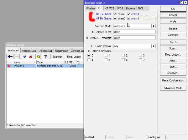

Look of all chains are selected. See picture chain
If not result

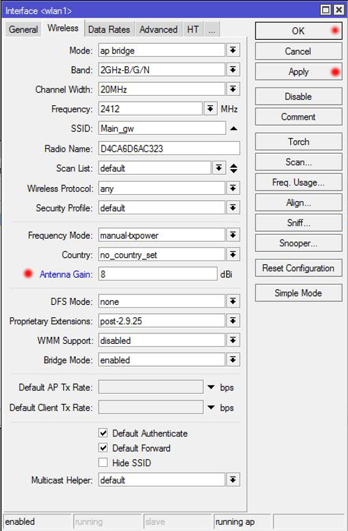

Try with reduce the power from your routerboard
Click on wireless and click on “advanced”
Maby is the signal to strong.

Here is my configuration.
try B/G only 20Mhz channel
The problem seems to be the strong wifi signal from Mikrotik. I change the channel to 6 (same as the client) and reduce the signal power.
Frequency mode: regulatory-domain
Antenna Gain: 15
Now work more stable an with more speed.
