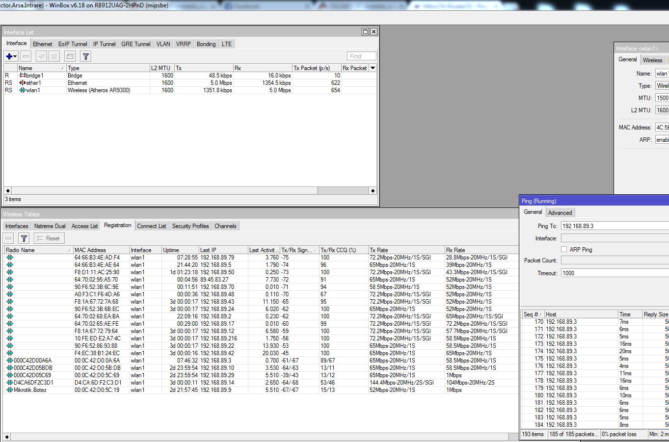

Poor Wireless performance in B/G mode 2.4 Ghz with Mikrotik.
What routerboard do you use?
Configure youre country settings.
Try another channel.

Set ack to 1.5 Km distance
The ping times are normal on Nv2
802.11 has smaller ping times.
Have you already tried 6.19 and updated the bios?
Try with bandwidth tool how match troughput you have.

How is your setup?
How match clients connect with this accesspoint?
Check out more clearly describe the situation.
Make a sketch of your situation please.
Sorry for all my questions but try to help you.
The 3 Routerboards on the sectors are the 3 routerboards in the same enclosure?
