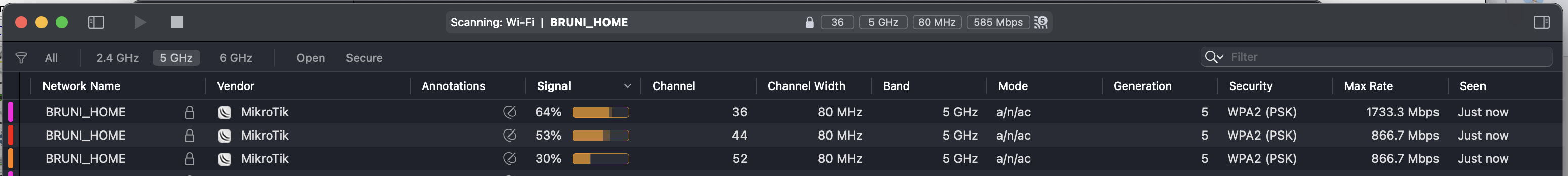

PSS: WLAN Analyzer (I have the RB4011 + 2 Access Points)
