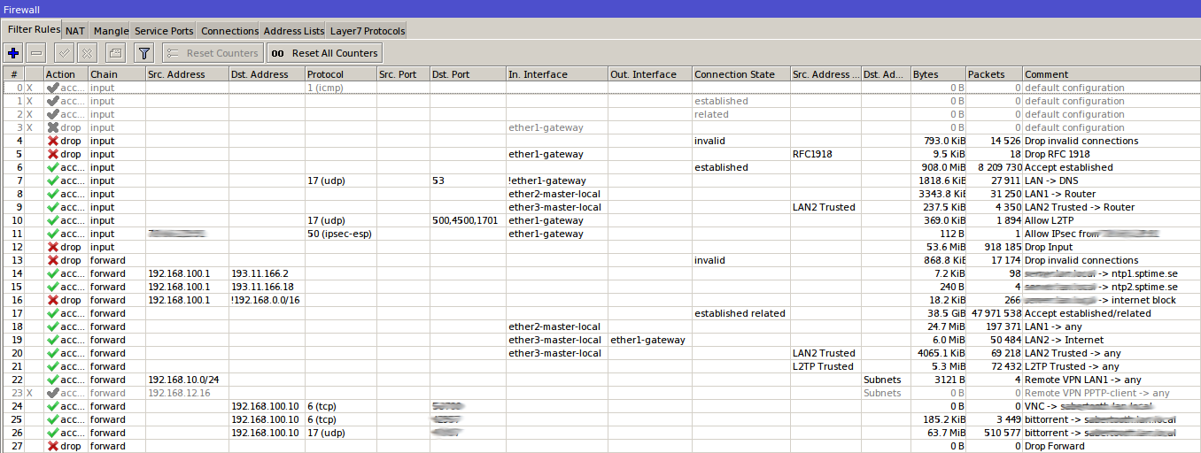

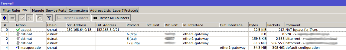

When I do a port-scan on my public IP, using a tool on my phone (connected to the internet through my phone operator, not WLAN), it reports ports 21 and 554 as open. Makes me nervous.. Those ports are certainly not open in the firewall section when i connect with Winbox. What’s going on?

simplest explanation is normally the correct one.
You have ports open.
If you need a more detailed answer, you will need to post your firewall filter and nat exports.
Sorry about that:) Here is my config:
