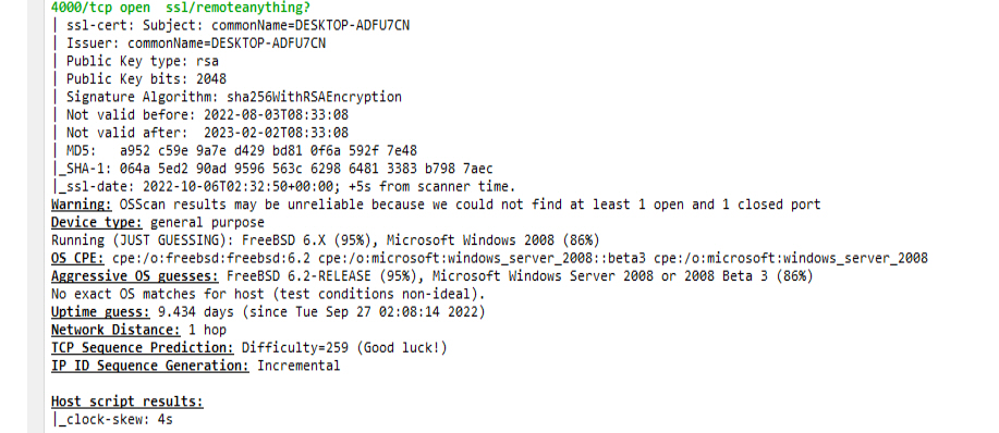

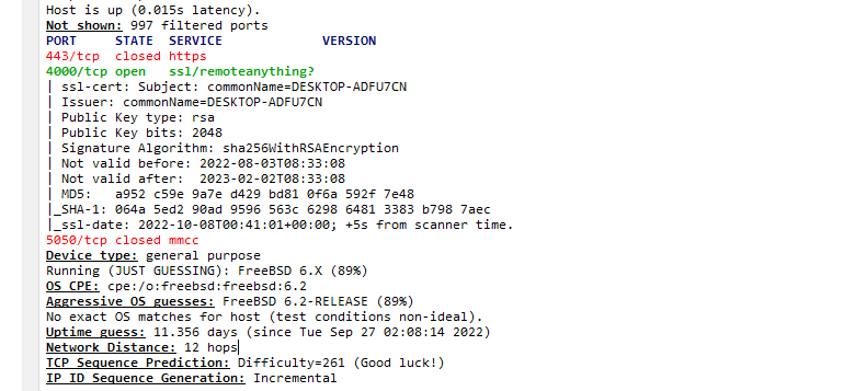

I recently notified that two of our clients have port 4000 opened on their Mikrotik routers. The firewall itself did not have the rules for the port 4000 open. We only discovered it by NMAP port scanning did on the WAN side. Both of them have the same commonName=DESKTOP-ADFU7CN. Is this something concerning?
https://i.postimg.cc/6QSTMbXw/2022-10-08-12-00-54.jpg
https://i.postimg.cc/Vvwfh3Hy/2022-10-08-12-07-07.jpg

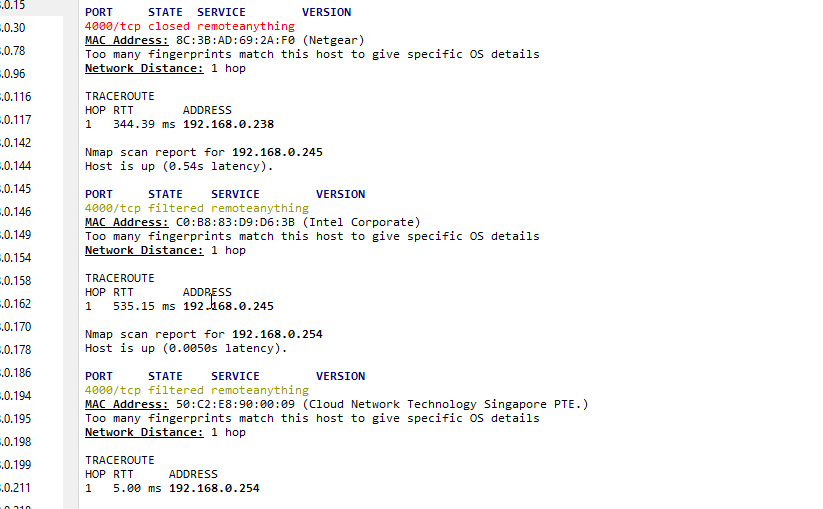

I did port scanning in LAN, it came up with something like this:
https://i.postimg.cc/CLYRvL5x/2022-10-08-15-01-38.jpg
If these are “MikroTik routers”, why do their MAC OUI prefixes belong to Intel and a subsidiary of Foxconn?
