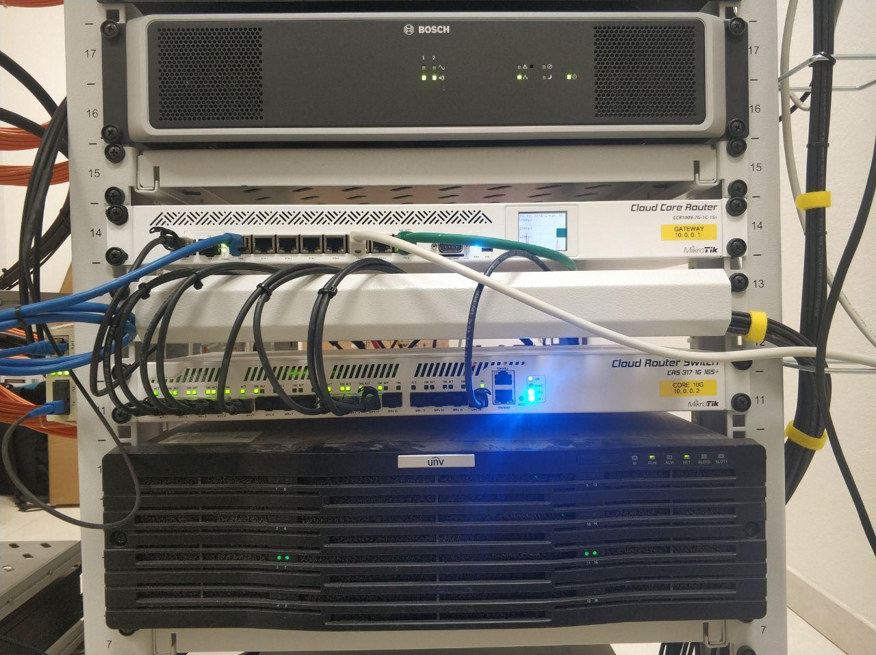

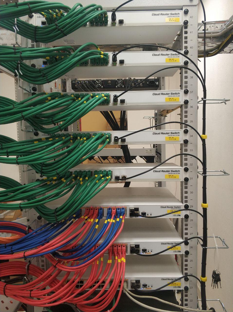

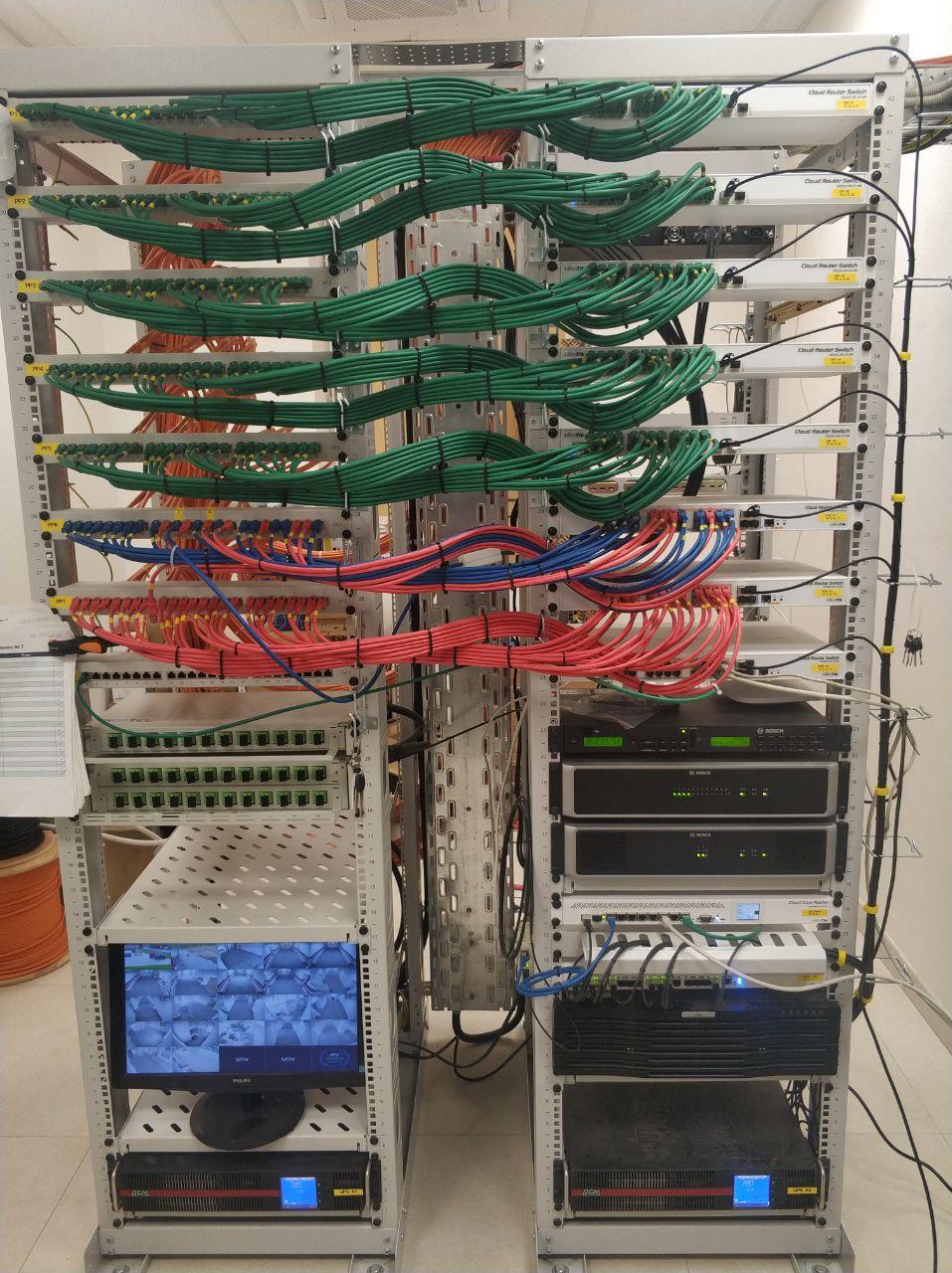

We have next network hardware:
  • 1x main gateway CCR1009-7G-1C-1S+
  • 1x core 10G switch CRS317-1G-16S+
  • 5x managed switches CRS326-24G-2S+
  • 3x managed poe-switches CRS328-24P-4S+RM
CCR connected to CRS317 using S+DA0003.
CRS328 and CRS326 connected to CRS317 using S+DA0003.
On CCR and CRS used 3 software bridges + 3 VLANS (core + work + guest).
10G used as trunk.
All work fine, low load CPU, memory etc, last RouterOS 6.47.2, last RouterBOOT, but…periodically flapping ports (all to CRS328 / POE):
