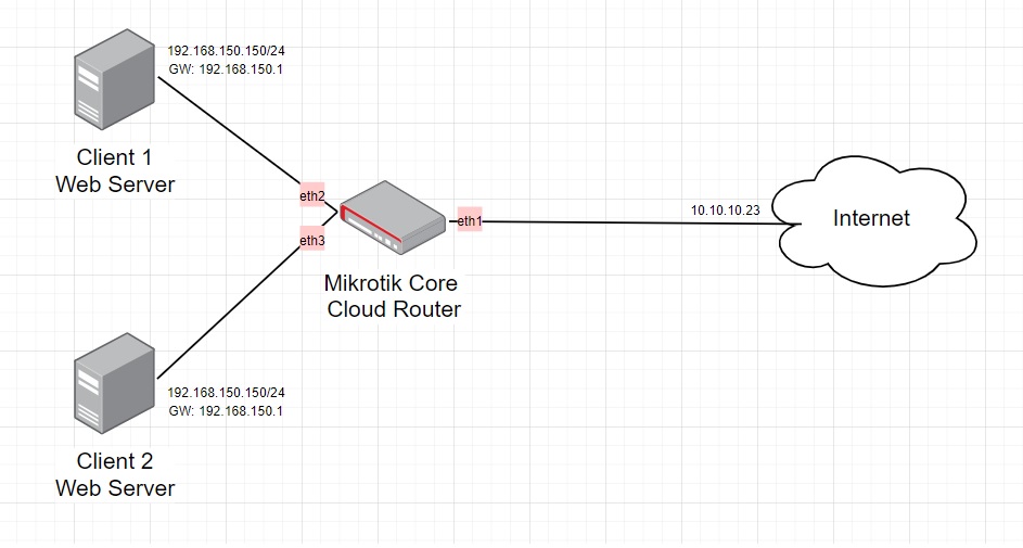

@pattemo Assuming the two servers can already be reached at the moment, can you draw a network diagram of how it works now? And how/why does the new situation differ from the current one?
Where are those ‘separate networks’ you mentioned terminated? Does that happen on the Mikrotik CCR in your diagram or is there another device you didn’t show in the diagram? If it’s on the CCR, then just adjust your mangle rules to filter on the dst-address of each client
I think we’re getting caught up in a confusing use of “client” here. Study the diagram. OP refers to two business client hosts running servers on the same IP. The network clients are across the Internet, if I’m reading this correctly.
Yeah, it’s starting to get confusing but I also meant the dst-address of the business client not network client. As in I assume that client 1 has their own external ip A.B.C.1 that was being forwarded to 192.168.150.150 and client 2 had A.B.C.2 that was also being forwarded to 192.168.150.150.
In any case, I guess OP needs some form of ingress filtering but we can’t advise on that without a better understanding of how the networks of those clients were separated originally. Maybe OP could make a diagram of the original situation he mentioned:
Their server was initially configured as a stand-alone, and since they are on entirely separate networks
Basically we need to port forward the ip addresses of client1 (ether2) and client2 (ether3) which is 192.168.150.150. In this case, they have a same ip address. Both client1 and client2 are connected on a single mikrotik CCR. We will use a single wan ip(ether1) which is 10.10.10.23
The scenario is the when a user access 10.10.10.23:9999(sample port only) then it will redirect to client1 192.168.150.150:80.
Then if another user access 10.10.10.23:9998(sample port only)then it will redirect to client2 192.168.150.150:80
