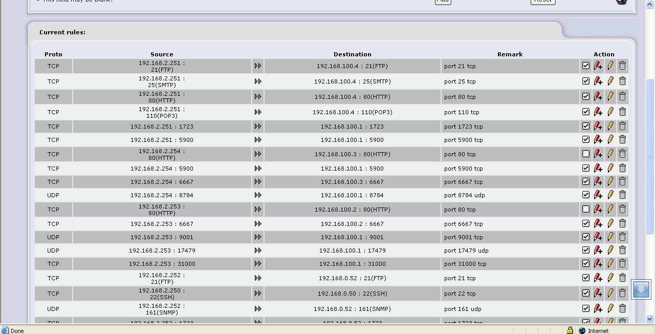

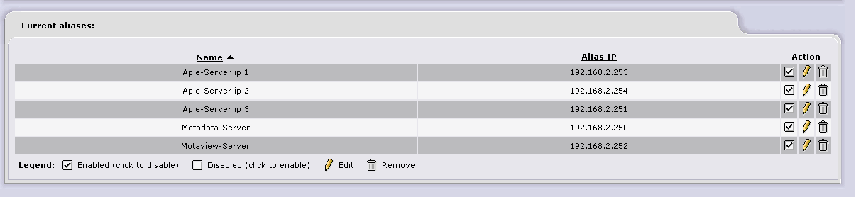

Ok try this.
  1. You can give ipcop static ip address or leave it that way. In alias create 192.168.88.250 but make sure that that ip is not being used. Then in port forward choose tcp or udp ,change default alias to your new alias, in distination ip put the ip of computer you want port to be forwarded to. In source port put the port number, do the same in distination port.
Doing that should not bring down your system. Maybe you system went down due to ip conflict or the dhcp assigned thing.
Good Luck
Look at my settings
