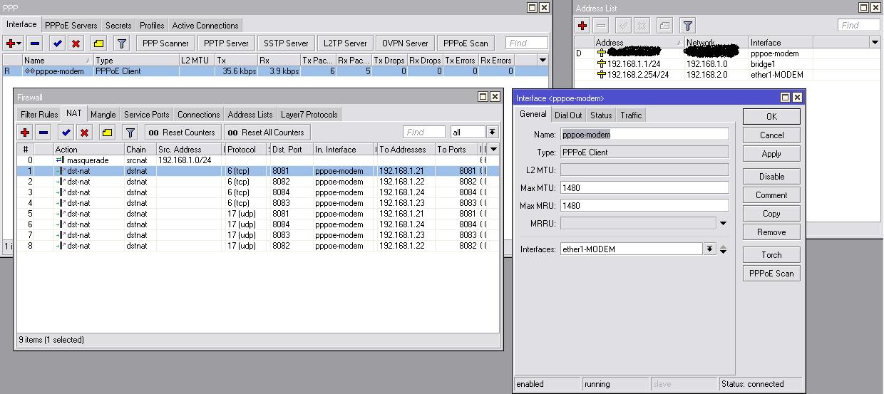

If this help you more, here is my configuration, of my mikrotik device, with bridged modem connected with pppoe in ether1-MODEM
and all the firewall rules for the 4 cameras i have.
my lan network is 192.168.1.0/24.
my cameras: 192.168.1.21-22-23-24.
I put an ip to my modem 192.168.2.1 and 192.168.1.254/24 to my mikrotik ether1-MODEM so i can log to my modem too.
I also made a dns entry on a free dns site (no-ip.com) for watching my cameras with my dns name.
I hope that helps you…
