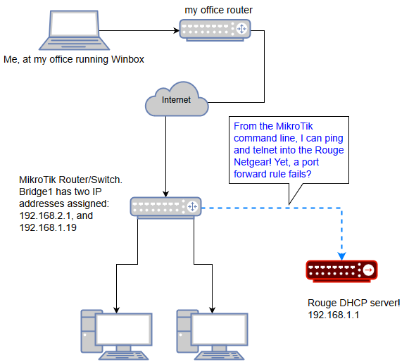

I have a network that someone plugged in a Netgear router/switch combo into. It has DHCP services running on it too, of course. Thus on my MikroTik, I received a DHCP alert that let me know the MAC address. Then I looked up its IP address under Bridge / Hosts. All good.
So, I remote into my MikroTik, assign my Bridge1 something in the same IP range as the Netgear. So, my Bridge1 now has two IP addresses assigned to it. I open up a terminal in Winbox, and I can ping the Rogue device. I then telnet to it on port 80 and issue a HTTP get request, and it replies back with HTML. All good.
So, I setup a port forward in my nat rules, but to my surprise, I am not able to open a browser window. Yes, I do see my nat rules counting bytes. I also tried VPN’ing into my router and was not able to access it from the VPN client.
What am I missing? Why can I interact with the Rogue box from the MikroTik command line, but not anywhere else?
