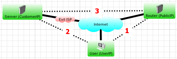

It will be like this:
1.) User tries to connect to PublicIP:443 (way 1)
2.) Router will forward the packet to CustomerIP:4343 (way 3)
3.) Server will see packet from UserIP (assuming something does not block it on the way for having seemingly spoofed source)
4.) Server will send reply directly to UserIP (way 2)
5.) User will discard the reply, because it does not expect anything from CustomerIP (more likely the firewall on User’s router will drop it as invalid)
With additional rule:
add action=masquerade chain=srcnat dst-address=CustomerIP \
    dst-port=4343 protocol=tcp
3.) New rule will catch the outgoing packet to CustomerIP:4343 and change source to PublicIP (* or any other IP on Router)
4.) Server will see packet from PublicIP ()
5.) Server sends the reply to PublicIP (
) (way 3)
6.) Thanks to connection tracking, Router will know where the reply packet belongs to, it will automatically rewrite its source address from CustomerIP to PublicIP and send it back to UserIP (way 1)
7.) User will get reply from PublicIP as expected
8.) User is happy, because it works :wink:
It’s poor man’s reverse proxy. It kind of sucks (e.g. there’s no way for Server to know User’s address), but it works. Try it. I did.
